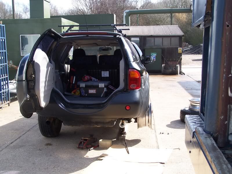

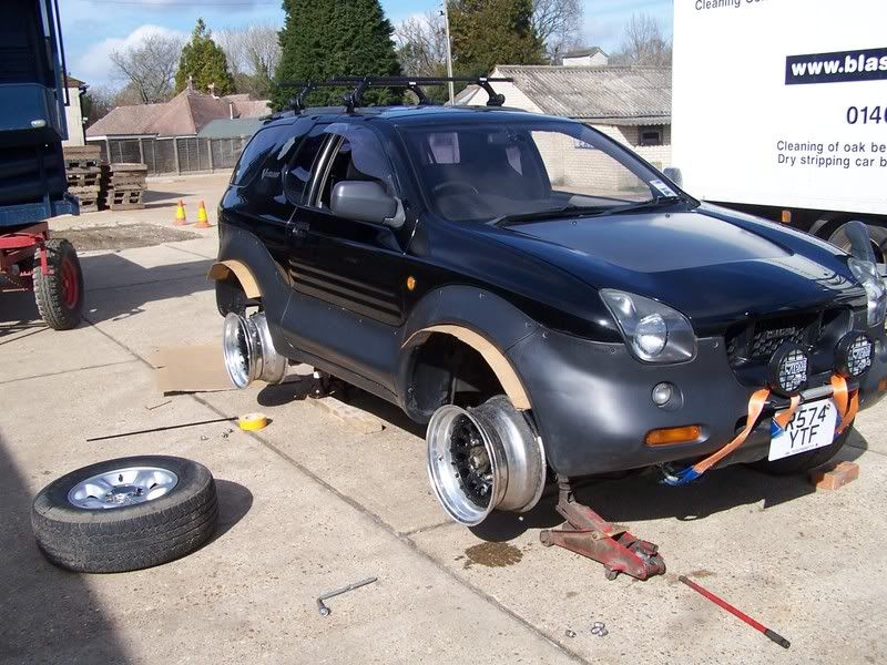

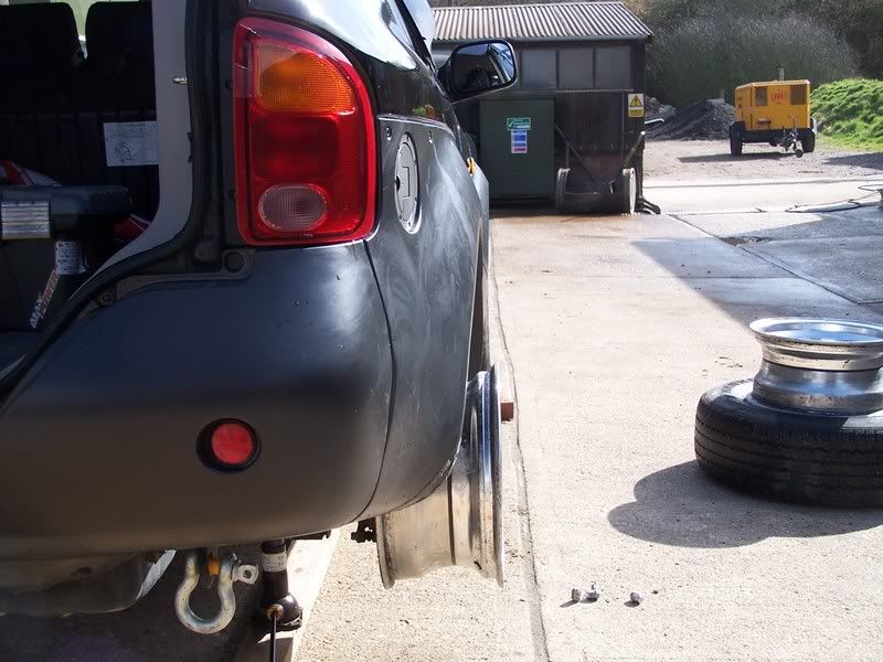

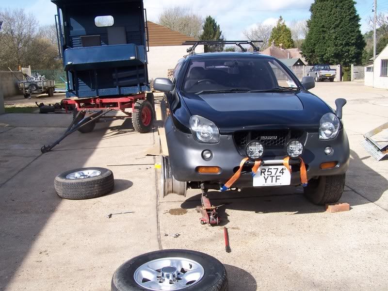

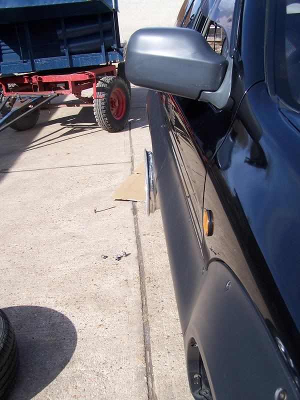

    I am REALLY struggling on what to do with my VX, i did the Lift with the OME 912's and 10 cranks of the front torsion bars last weekend and test fitted some 16 x 9" rims. Problem is they are -19mm offset so they throw the wheels out of the arches quite a way
    Especially with the 285 75 16 tyres. In this country they have to be covered and the only thing i can find to do that is this http://www.qtservices.co.uk/product.asp?id=2913# but im worried it is going to look nasty instead of mean!! something like this??
    Or would the smaller 45mm fender extension that Ldub has be sufficient???

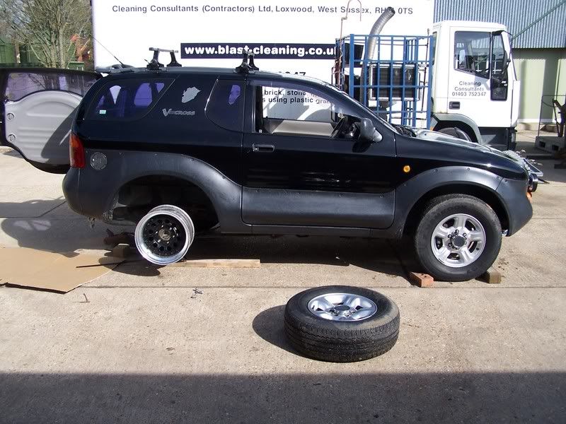

    and here is the lifted VX

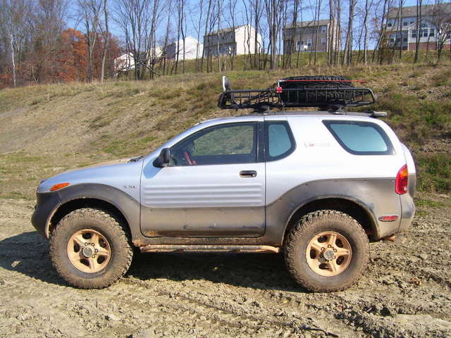

    Well, with -19 you are going to get a pretty beefy look. It's hard to say without seeing some meat on those wheels.
    My wheels have a 0 offset, so just for reference, here is how far they stick out:

    If I were you I would get the 285/75-16 MASTERCRAFT COURSER MTs. The rims you have already will look pretty sweet with some 285 wide tires, and surprisingly the 285 tires are really not going to stick out much further than the 9" rim (around 1" more). With a 9" rim and -19 offset you are looking at 4.25" backspacing, and my 8.5" rims with a +15 offset have a little over a 5.25" backspacing. So yes your RIMS stick out over 1" more than mine, but since you are looking at 285 tires (11" wide roughly) and I have 12.5" wide tires you tires will probably only stick out about 3/4" more than mine. I think you will be close to in the ballpark with the 285s on the current rims you have. It would not be my 1st choice, but considering you already have the rims I would at least try to 285s out for a while, I think it will grow on you and you will like it. If you were however throwing some 12.5" tires on there I would say no way. I gave you all the comparisons so you could compare and visualize using some of my photos if you want, here is one thread that might help in the visualization area:
