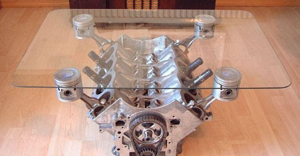

    Well Yeah...I've always wanted an aluminium engine block, as the base for a coffee table...no, I'm serious.
    I have a pic somewhere of one, & the owner stored bottles of fine wine in the cylinder bores...
    3,761
    wow, thats horrible...what a waste of a motor lol....
    I have to agree. See, "fine" wine is still wine. Now, if it was storing chilled Jager...

    Agreed, THAT is badddddaasssssss looking. Me personally, I would have the whole thing coated in Instant Rust to give it that rustic look or maybe have it dipped in liquid black plastic coating. Really cool either way. I love the use of found objects and recycled objects for making new, functional, artistic pieces.
