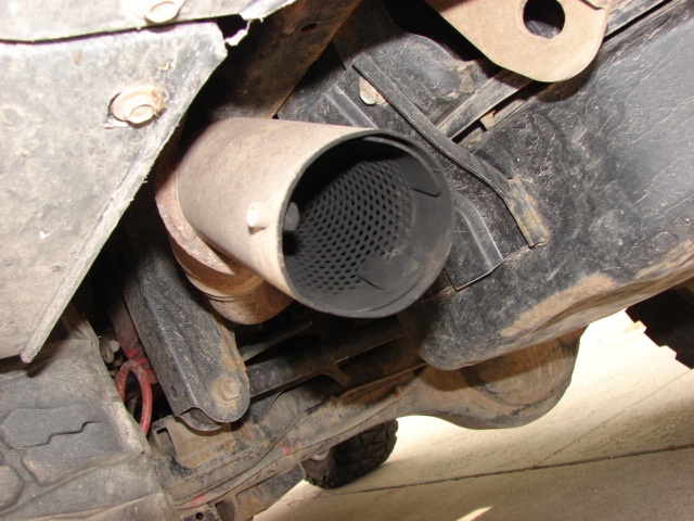

is there any type of tip out there that will just silence the exhaust a little???
with jo getting this and me in my integra im worried about getting another one in my VX....
i have a PV2 (i know its loud) so im just wondering if there is a tip i can throw on there till they calm down with this noise thing?
Yep...this will knock a few dB off.
http://store.summitracing.com/partde...5&autoview=sku
I installed one in my OEM exhaust tip, after I found that my Borla "Turbo" was a little raspier than I would have liked.
The angle of the pic makes it look shorter than it actually is, in theory, the surface area of the perforations is greater than the cross section of the pipe feeding the tip, so it shouldn't restrict flow very much, if at all.
Also, it's a REAL tight fit, & required a rather robust amount of flogging with the two pounder, not to mention a box full of foul language...
