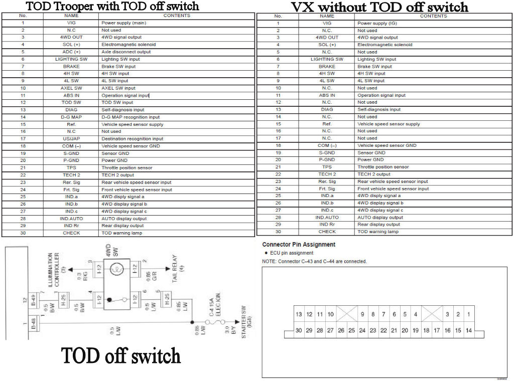

Is it just me or does it look like all you need to do is connect a switch between pin 1 and pin 12 of the input harness on the TOD ECU to make a TOD off switch?
Tad, Nazrat on here, has his disconnected. All you need to do is cut the blue wire under the passanger seat I think. He wired it up to a 4wd switch so he can turn it on and off. It just shuts off the electromagnetic clutch, so if you have manual hubs you cna completely seperate the front drivetrain and have true 2WD.

Yeah I’ve seen it done like that before, it just doesn’t seem like that’s the right way to do it. If this setup works it will not only shut off the TOD the way it was designed to be shut off, it will also show that the TOD is off on the TOD indicator on the dash. It would make it just that much cooler.![]()

I think the better way to make sure this mod can positivetly work 100% is to get the trooper's TOD schematics & match it to our TOD to see if this 4WD to 2WD really works without any possible issues in the future.

It seems that the only way you can get really 2WD is swapping the trooper's TOD to the VX.
There's few TOD pin functions that differs from each other,that makes me assume that the software is also different.
Pin # 5 (ADC) axle disconnect output on the trooper's TOD VX #5 pin (NC) Not use.
Pin # 12 on the trooper's TOD (TOD switch input) VX's TOD pin # 12 (Not use)
Pin # 10 on the trooper's TOD ( Axle switch input) VX's TOD pin # 10 (not use)
Pin # 14 on the trooper's TOD (D-G map recognition input) VX's TOD pin # 14 (not use)
Pin # 17 on the trooper's TOD ( US/JAP destination recognition input) VX's TOD pin # 17 (not use)
So probably there's no room for such mod for our VX

I’ve read everything on this site that has anything to do with TOD shut off and there’s nothing like this. Thanks to taylorRichies Isuzu workshop manuals post I was able to cross referents the differences between the TOD setup on the Trooper and the VX. I’m hoping that just because pin 12 is not being used that it doesn’t mean that the option doesn’t exist. I’m going to find the part number for the TOD ECU tomorrow and if it matches the Troopers then I’m going to take this to the next step.

Well so far I haven’t found the part number for the Trooper TOD ECU. This is a layout of the two different TOD systems. It looks like even with the clutch pack disengaged there will still be a minuscule amount of friction in the clutch pack. So there will always be a little power going to the front. My plan is to have the TOD go into 2H in the way it was designed to go into 2H and not try and trick it. If the ECUs match and I figure out WTH the axel position swtch is for. I’ll start doing some test.
