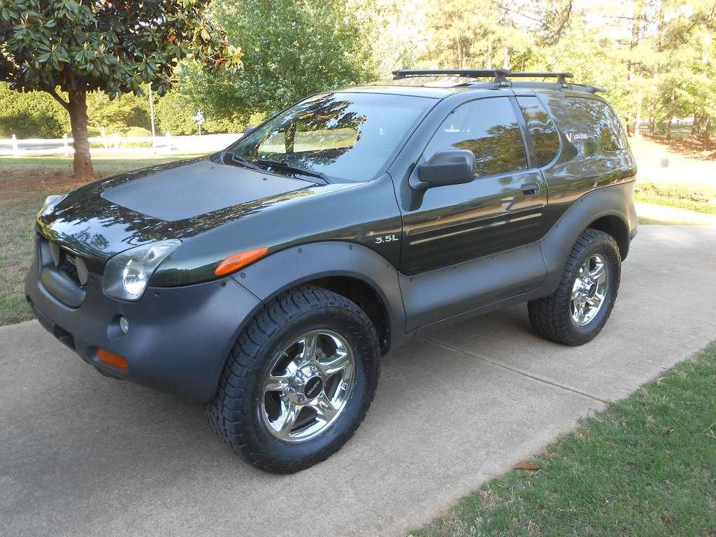

    Man, I can't believe how many combos there are out there. Cool to see them all in one place.
    And why can't my VX's paint job look like this:
    Wax on - wax off, gasmask san...
    Yours can't look like that cuz you...OFF-ROAD!

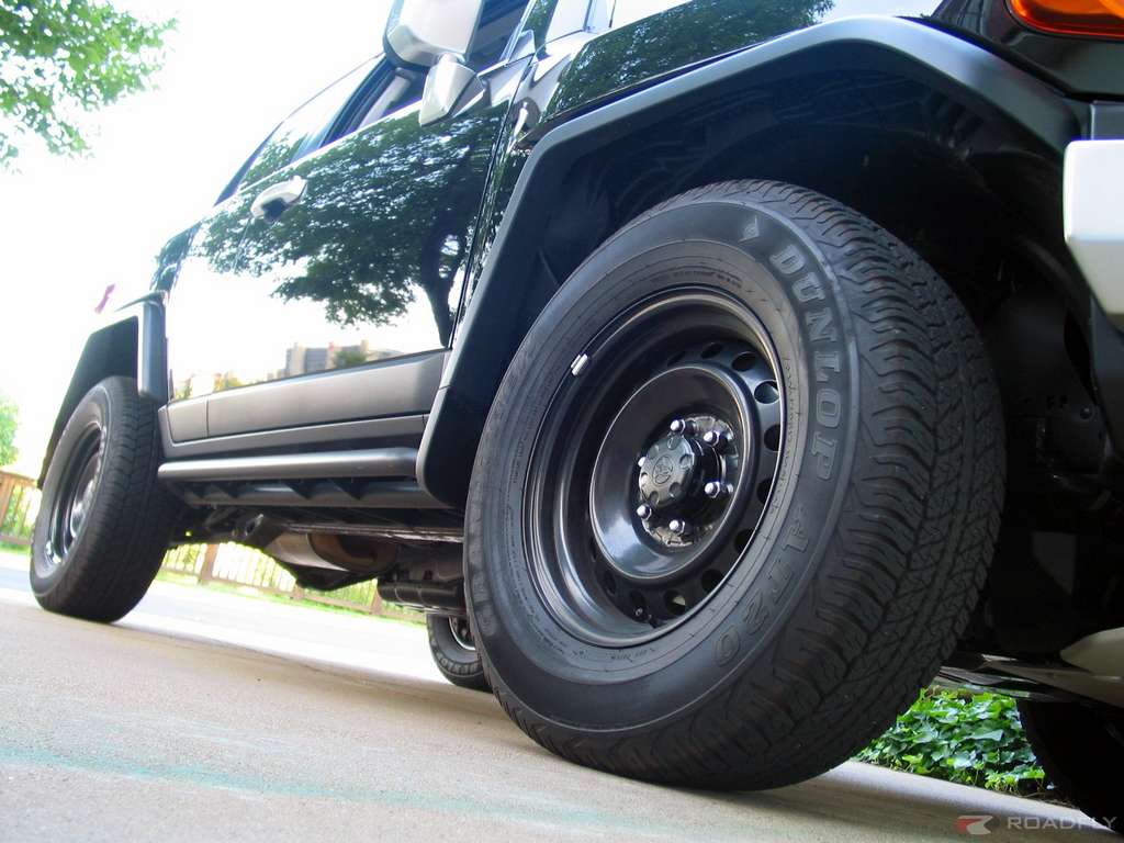

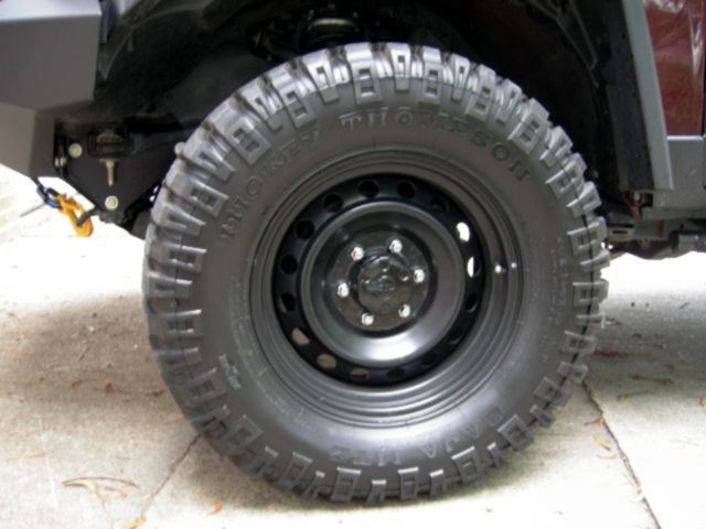

    There’s just something about the FJs OEM 17in steel wheels. With some flat mat black paint and some nice MTs or some Baja tires it would look so tuff.

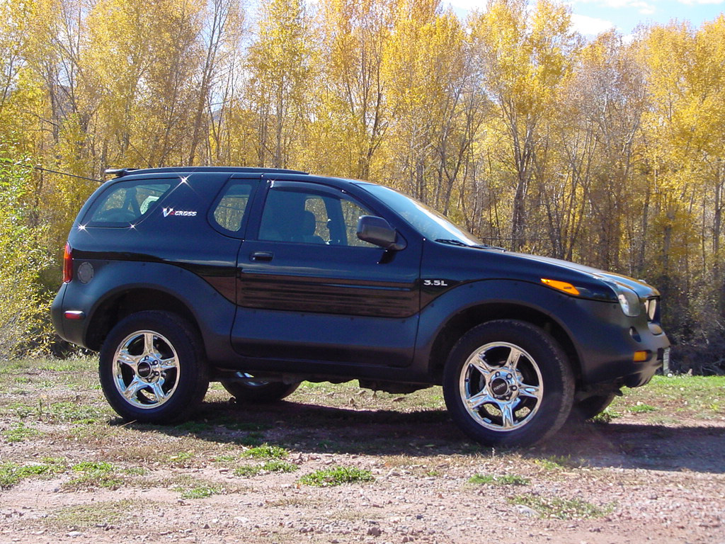

    Check out these bad boys:
    Yeah, that's right! Rollin' Geolanders wrapped around some SWEET 'teens from Isuzu. Sorry, just had to put that up.
    I'm with Bart; how come my VX doesn't get that clean. I saw that picture and it looks like the paint is liquid. Nice job!!
    Any more info on this build? I am also interested in doing…the exact same thing. Will they fit with a 912 or OME build?
    I just put those same wheels in 16" on my 91 Trooper. Be aware they have a pretty positive offset. Originally, I put 265/75s on the Trooper and I had rubbing on the frame at full lock. I took off the 265/75s (will be putting them on the VX) and put some 235/85s on the Trooper and I get no rubbing now.
    They look classic and nice I think.

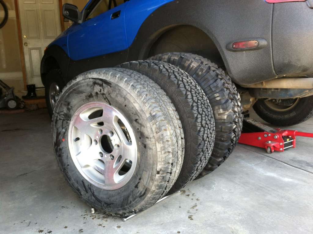

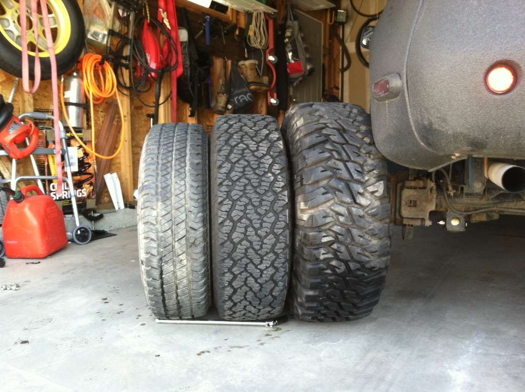

    I was changing my wheels over from winter (31's) to summer (33's) and happened to have a stock size tire too. So I posted these pictures in case some of you are interested in a side by side comparison.
    These are stock for a '99 245/70r16 then Gen Grabbers AT2 265/70r16 and GoodYear MT/R 33/12.5r15
