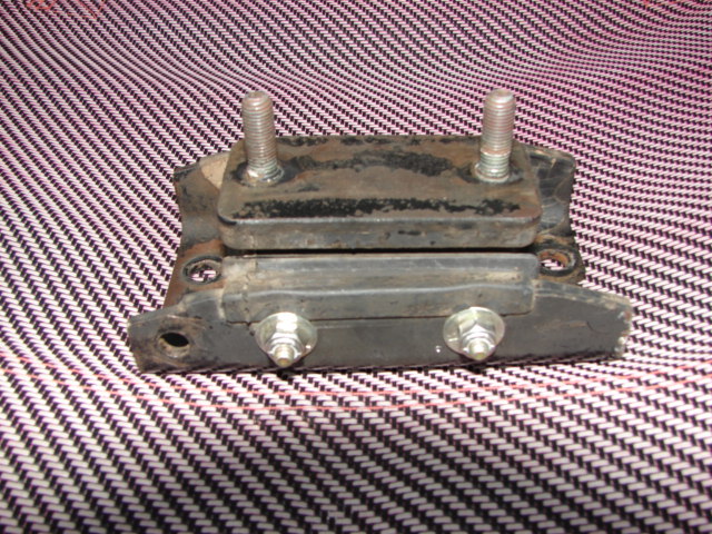

OR, if you're buck$ down & feeling a little creative...you could fix it by drilling a couple holes & "pinning" it solid with a couple grade 8, 1/4" bolts with stainless washers & nylock nuts...
>disclaimer<...I did this about a month ago & so far it's good. But have no idea of the longevity of this fix...![]()

After reading elsewhere in the forums about another member (Joe Black) who cured his "clunk" noise by replacing the trans. mount, I couldn't NOT take it all apart to see (that wasn't it)...figured as long as I had it out, WTH, might as well pin that sucker solid & never give it another thought...

After several months of use & abuse, it turns out 1/4" bolts aren't beefy enough. The torque load has sheared off both of the bolts I had in there.
Looks like I've got another project to get done before the snow flies...(gonna upgrade to 3/8 or 1/2")

Finally gave myself a kick in the pants & decided to get after the "beef up the tranny mount" mod...
Had all the skid plates & the cross member dropped before TLMP had french toast on the table this morning...Drool
(I swear the woman must think pot bellies are sexy or sumpin....
After ........., we went to the hardware, & picked up some 1/2" grade 8 bolts of the five inch variety.
If you care to read earlier posts in this thread, you'll see where they go.(the original 1/4" grade 8's sheared off...)
After re-drilling the mount, from 1/4" to 1/2", & hammering the bolts through, I loctite'd the nuts on & reassembled it all...with more loctite on every bolt of course...
Just got back from a test drive & DUB'S A HAPPY CAMPER!(test driven in city & highway conditions)
Not only is 96+% of the "clunk" gone, but the weird indescribable whirring (yeah, I know, I just described it, but thas not exactly it) noise is GONE!...
Another couple things...slight engine vibration can now be felt in the steering wheel while sitting at a stop, in gear.
Not unexpected, as this is now a solid mount.
