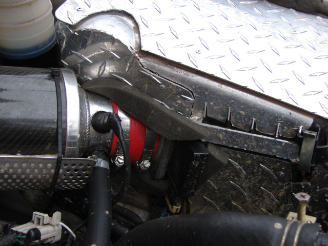

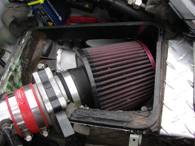

    i think the pod filter they are talking about is just a universal 3" inlet cone style filter. the benefits are a much less restricted intake, the downside is a pretty significant heat gain, you could remedy that by putting in a heat shield of some kind but im pretty sure that would need to be fabbed on your own
    It can be done with some serious surgery to the stock air box...

    Thanks Man...it ain't exactly pretty, & has a few rough edges here & there, but in side by side testing with Kenny's VX on the same stretch of road, at the same time, my intake air temp was about six degrees cooler due to all the insulation I've done on the inside of the box & also the inner walls of the c/f intake toob.

    That green stuff you see on the rear edge of the box is 1/4", foil faced styrofoam commonly used behind steel siding. I cut pieces to fit wherever I could & glued them in place with silicone.
    I packed plain old fiberglass insulation between the inner (straight through aluminium) & the outer (c/f) walls of the intake tube.
