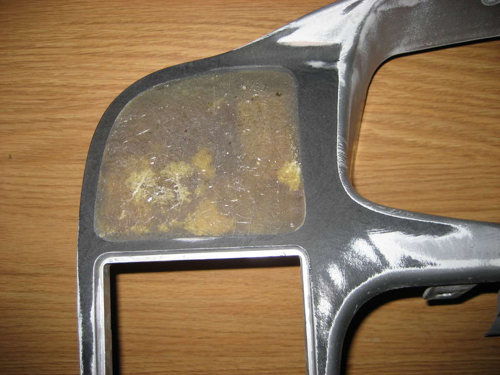

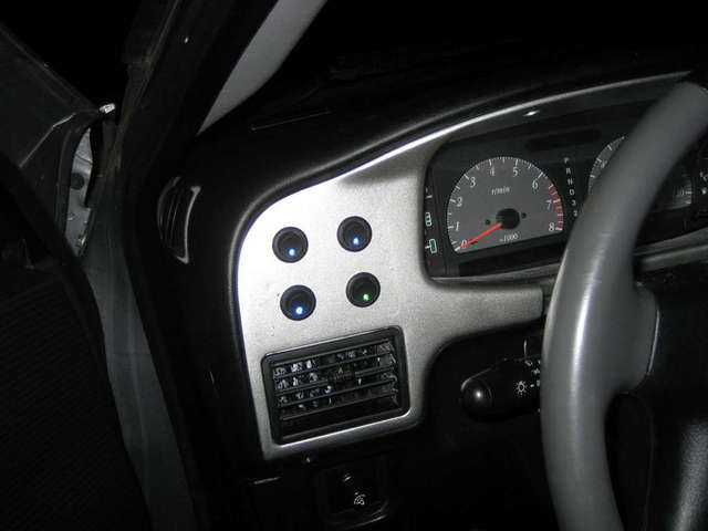

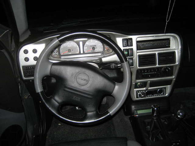

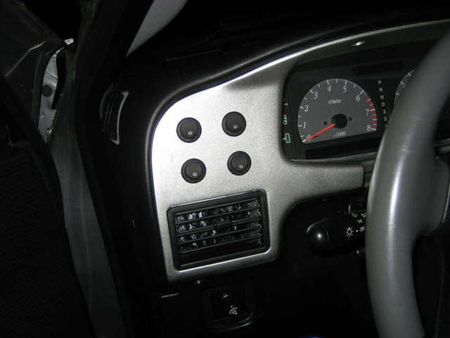

    took me forever to do it because ive been all sorts of busy.. but i finally mostly finished fiberglassing the spot of the fuzzy hole so i could add my own switches for my fan, lights etc..
    Switches off
    Switches on
    Whole dash

    Nicely done. However if anyone else tried to drive your car I am afraid they might not know which switch does what. But then again that might be the point, lol. Looks good though. Very professionally done.

    originally i fiberglasssed over the entire area with a very thin layer so to hide the seams... well as soon as i got it painted it cracked as i was trying to drill out the holes for the switches..
    so i broke out a big hammer and screwdriver and knocked the fiberglass out completely and started over just filling in the fuzzy hole
    after lots and lots and lots and lots of sanding...
    then after even more sanding it was smooooooooth
    then a few layers of rustoleum metallic all purpose spray paint... some wet sanding and a clearcoat i drilled out the holes for the switches and voila!
    except after a day of being dry bubbles started to appear around the edge of the fuzzy hole.. so ill one day repaint it.. but it doesnt look bad at all

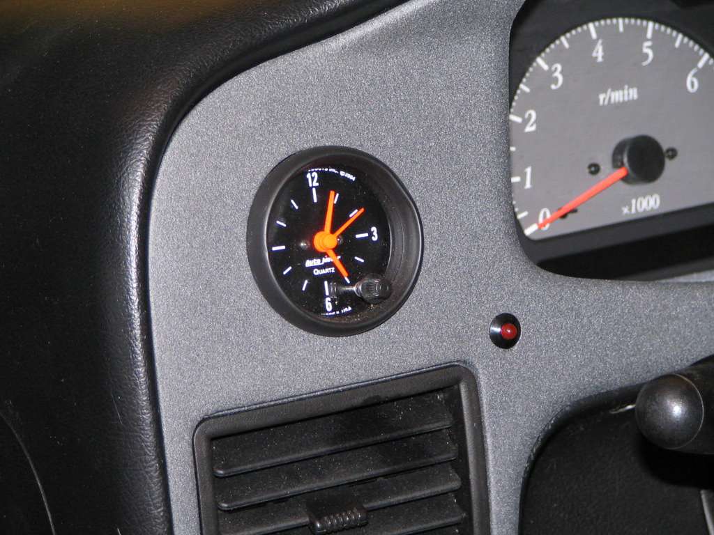

    Kind of like what I did. But I used a piece of plexiglas using the cubby hole thing as a pattern, epoxied it in and used some as a filler, sanded and painted after cutting hole for the clock.
    yep, rowhard, your clock was my inspiration for this mod!
    littlebeast, i dont let anyone else drive my VX! haha my next mod (probably will go in the center of those switches) is an ignition safety with an analog coded "key" that must be inserted before the ignition will work... i am considering labeling them though, not sure the best way to do it
