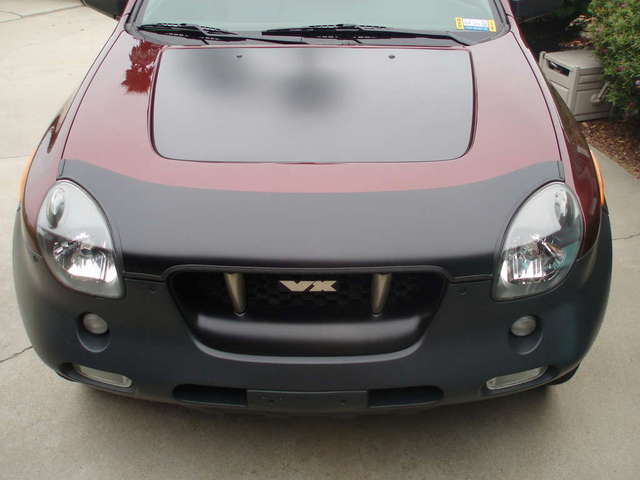

    I have a puncture in my lower front cladding where the P.O. must have “speared” something.
    I realize that a VX Concepts front skid plate would cover this area nicely and I would do anything short of a federal crime to buy one…
    I also have downloaded the specs of the full/front belly skid plate that Kenny had fab’ed (awesome work, BTW), and snowtrooper1966’s option, and those are other options. http://vehicross.info/forums/showthr...ght=skid+plate
    I just don’t have a good fabrication shop here.
    Besides those options, which I consider ranked in order, has anyone ever done a cladding patch? That particular crook in the front cladding is prettey rigid, would it take and hold some form of bondo with a touch-up painting?
    I realize that it’s not that bad of a deal but I zone-in on the defect everytime a gaze lovingly at the VX. Thanks in advance for any suggestions.

    You may still be able to buy Naoki's version of the front skid plate. Different materials but excellent workmanship. Costly coming from Japan but worth it.
    Naoki page
    http://homepage3.nifty.com/vehi/shop...shopping15.htm
    Dutchie is the VX site member who was the contact with Naoki

    You can have a local body show match the cladding color with a flat paint then use some light filler. You would be surprised how well that works. It looks like a fairly small area so it wouldn’t take much.

    I pierced my cladding in the rear - end of a ladder caught it. I carefully taped off the punctures (they were long cuts) and applied black caulk I purchased at Home Depot. It's not perfect but not as noticeable as the holes were. I'll eventually buy a new rear bumper cladding piece. They are still available, as is the front through St. Charles Isuzu and that may be a better option for you (it's not as expnsive as you think - actually it's not too far off from the cost of a skid plate with shipping as shipping is free from St. Charles).

    Bren,
    I did a repair on my cladding with PC-7. It's a 2 part epoxy available from True Value. The color seemed to be a good match. My repair was in a hidden area so (reattaching a tab that I broke off during the hitch install). This stuff makes a pretty solid fill and can be sanded but best of all, it's easy to work with (stays where you put it). I've used it to repair body panels, fiberglass, ceramic, etc.
    They make PC-11 as well but that's for marine applications & is a blue-ish white color.
    If you want to try it & can't find it, let me know & I'll send you some.
