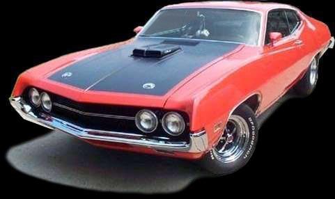

    Anybody try anything like this?
    Sorry, I grabbed the first photo out of the galery for my quick edit job.

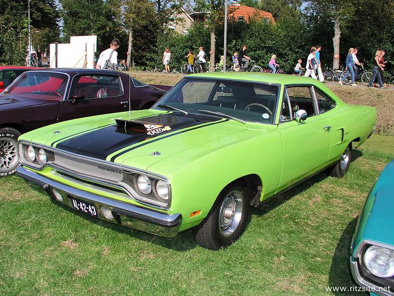

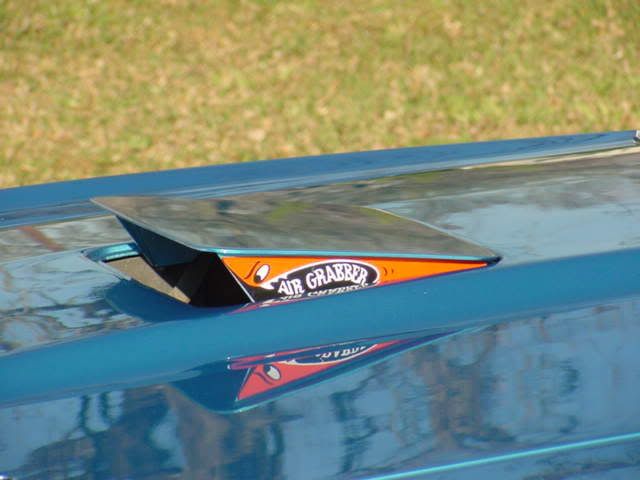

    Allright, you got me thinking back to my MOPAR days. The reason I was thinking cowl INDUCDTION, was I did not want a forward facing scoop to grab snow during the season. But there was a MOPAR design that allowed the driver to activate the ram air scoop from inside the cabin:
    I think I will investigate this a bit further. It would be sick to have a scoop on the dragon that has teeth and harkens back to my old muscle at the same time. You cant beat the "fliying tiger" inspired teeth design on this scoop, IMHO.

    Snowtrooper - I also see that you too enjoy Mopars! I've had the same thought and actually my little sketch was thinking along those lines. I have a Lemontwist/Velvet black, 383HiPro, 70RR with Airgrabber, but sadly it's still one of those projects that's in pieces and under a tarp (SOME DAY).
