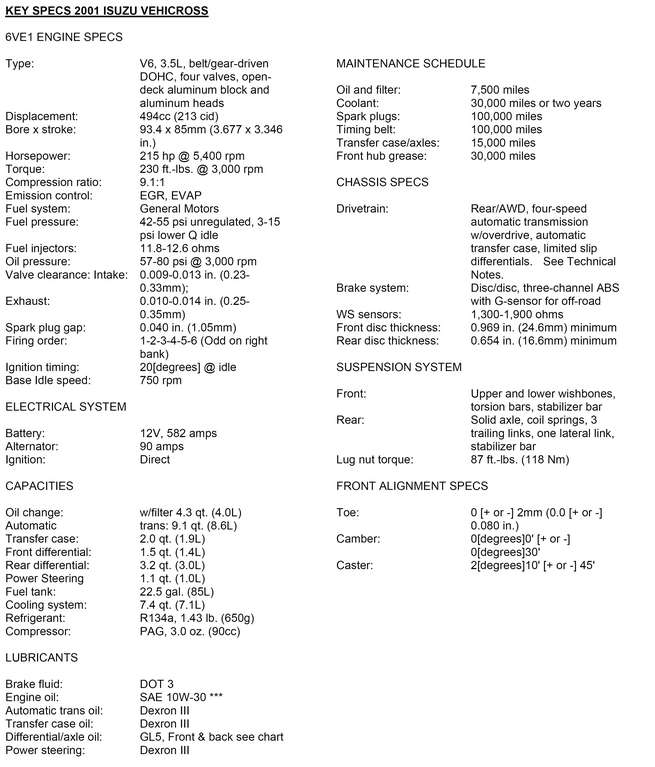

    I asked that question a few years ago. Here's what Tone wrote to me:
    Quantities have been posted many times before and are also listing in your owners manual - please try the search function.
    Approx amounts are as follows:
    Tranny flush - at least 10 qts Dexron III
    Tranny filter or drain - 4 qts Dexron III
    TOD/Transfer - 2qts Dexron III
    Front diff - 1.5qts
    Rear diff - 2qts
    75/140 in both is fine in Texas unless we have a cold winter
    Can't change any fluids too often - see manual for time/mileage periods
    @ 30K you also should be having your wheel bearings repacked....
    Hope this helps.
    Peace.
    012009
    I would also add that we can use the ATF fluid for our power steering fluid.
    So when getting a case - get a bit more to flush the power steering juice.
    And-

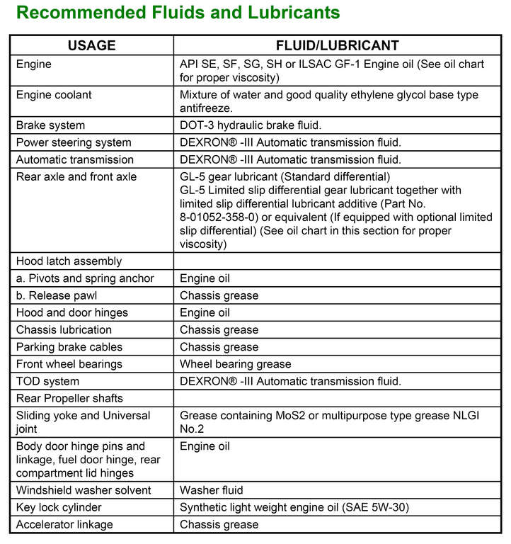

    Probably doesn't affect you, in your temperature zone - but the manual has different viscosities for fluid for front and back diffs. Others should check their local low temp for proper selection.
    I did all my fluids myself last year. Pretty painless. Maybe I can do a how to for all if needed....
    Some Data sheets:
    and another list..
    might help some people.

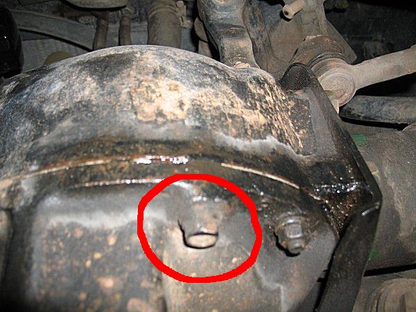

    Post Front diff ports, which is which?
    I don't like doing things unless I am 100% sure.
    Can someone point out which is the drain and which is the fill? I assume the big plug that is high up is the fill port. Now, according to Dub's earlier post, the lowest bolt should be the drain, so which one is it exactly?
    Fill???
    Drain???
    In the above photo you can clearly see the dripping problem I have also. I think Jharris might be right about it being the seal there. The manual mentions this as a potential problem.

    It's hard to tell from this angle, but I think it's this one...
    In any event, it's the one closest to the ground.
    And you are correct in your assumtion that the upper ones are the fill/level check holes.
  10. #25
    You're the best, Dub. I figured that was it, but with your red circle, now I am certain.
    Thanks -Bart
