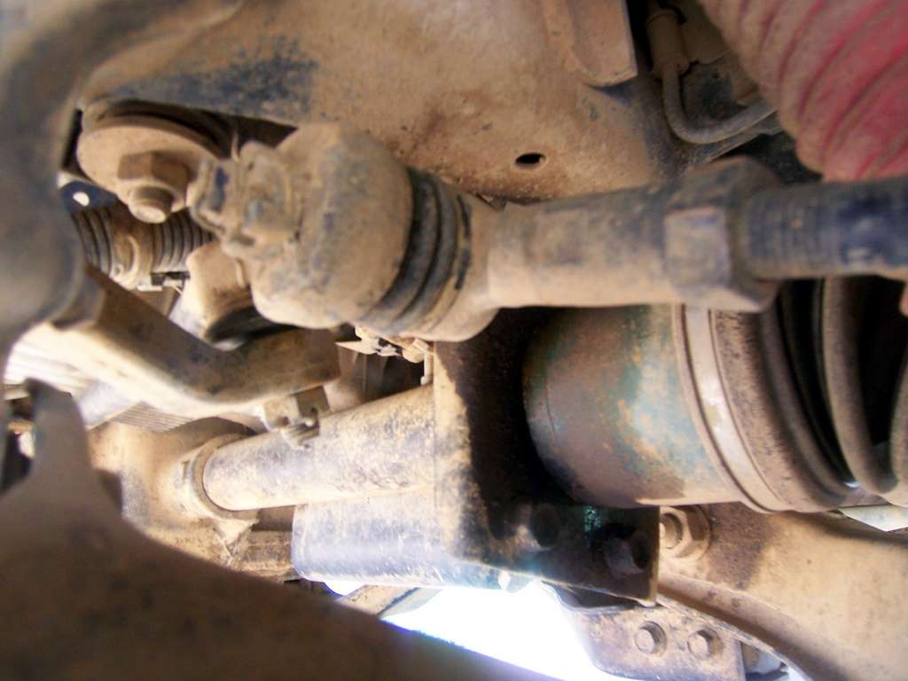

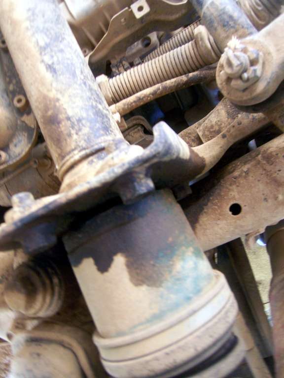

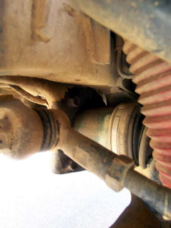

    This is what mine looks like.
    Richard, how many miles on your VX? This looks exactly like mine too, but your fluid looks more green? Makes me wonder, do we have coolant dripping down from somewhere? Are you SURE yours is diff fluid?
    It has 89k on it, that drip took about a day to develop. It doesn’t smell like antifreeze and it feels like oil.
    Yeah, then you are definitely leaking from the same place I am. Mine is the same, feels slimy, and most certainly doesn't smell like coolant. I think if it were coolant we would be smelling it hard once it heated up down there. Yours just looked green in that photo. So I am thinking diff fluid or engine oil. I'm gonna do the aforementioned cardboard trick tonight, that is, if I can get some jammed up ther in the right spot.
    As far as my leak goes, it seems like its coming out when I drive, not like a typical leak that leaks all the time, driving or parked. I can go under there and wipe it off as much as I can with a rag, and then its still dry in the morning. But after I drive, its wet again...
    Awesome! I’m going to check the dif fluid tomorrow and see if it looks green. I had them do full synthetic, I wounder if that’s what the dif fluid looks like?
    I have seen diff fluid turn greenish if water got into it and I have seen it turn rust color if it got really hot. I think I am going to agree with etl on this one. If the head or intake gasket cracked, couldn't it leak both oil and coolant, mixing it together?
    Perhaps. If it is a head or intake gasket, we are talking major engine work, correct?
    If it was a head gasket you'd start to see evidence of coolant in the oil. The oil in mine is perfect and I haven’t had to top it off since Moab.

    I would vote it is your seal. Just happens to be leaking from the opposite side mine is. Water most likely got into your oil and broke it down. Not only would I change the diff but also repack your bearings if you know you have been in mud or water recently.

    I should probably know this already, but where is the condensor for the AC located? Since it's been warmer out lately, have you been running the AC? Maybe what you're seeing is just accumulated water dripping off the condensor, which is collecting grease and grime as it makes it's way over dirty engine and chassis surfaces on it's way to the ground? That would also explain why it only seems to happen when the vehicle is driven.
    Well, my oil looks good too, I can't say the same for topping off, but it does not show signs of coolant mixing...
    That's cuz you are burning it all out! Two things - first, the "seal" around the diff mounts are just liquid gaskets - if the bolts back out and the diff starts to move around some, sure, it will leak. Tighten them back up and it may go away. This is the case on my VX. Second, the pinion oil seal... if that is what is leaking (again, such as the case with my VX) the front driveshaft would be removed, the pinion nut removed, the yoke removed, the oil seal removed, the crush collar removed, a new crush collar installed, a new oil seal installed, a new pinion nut installed - everything else would be reused but the preload will have to be set by a pro unless you can find access to the appropriate tool to do it yourself. If it is your oil seal at the pinion, parking on an incline will usually force fluid past the seal - it might not leak otherwise... unless of course when driving.
    When you say oil around the pinion seal, is that the engine? Sorry, I'm not that up to speed with all yer technical mech 50cent words. I'm still learning.
