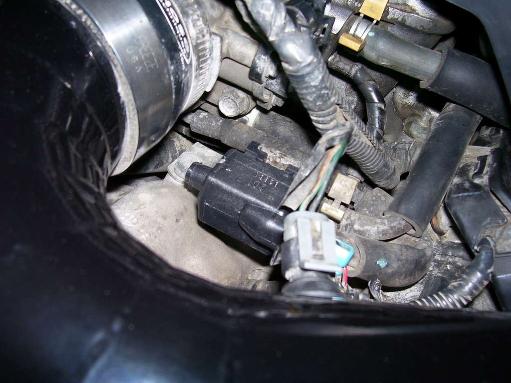

Then I installed a vacuum control solenoid (part #8-01997-201-0) that fixed my P0440 and P0405 fault codes:

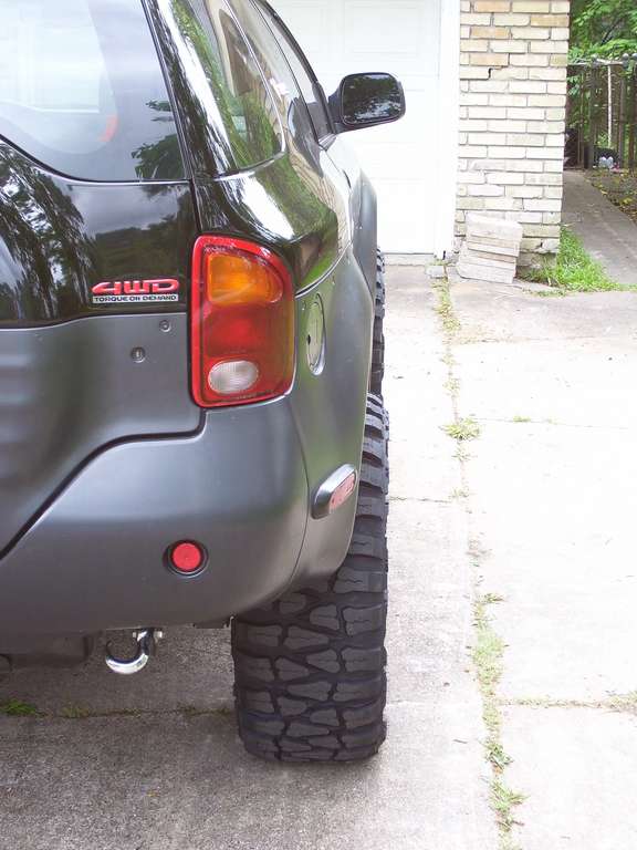

1st pic of tires and rims installed:
Before and after pics:
