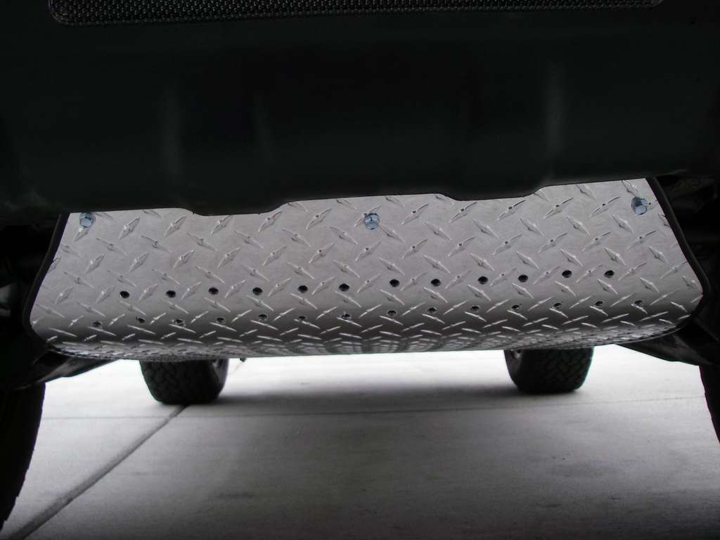

    Quote Originally Posted by don moore View Post
    Did you have to add spacers to it ..next to the frame?
    No spacers, they bolt right to the cross members below and to the tow hook bolts in the front. There is enough flex in the plates to make it work well.
    Quote Originally Posted by logman View Post
    Where do I get one of those! Are those drawings all I would need to get one of those built?
    The drawings are a start point. I would have the front brackets that tie into the tow hook threaded holes custom measured to get the angle right. Mine are a bit off... to lazy to make nice.
    Quote Originally Posted by snowtrooper1966 View Post
    Kenny!
    You 'da man!
    Than's exactly what I needed. What thickness stock was used? I see the cutout for the oil drain, and I am thinking this one peice protects the gas tank as well, since it goes so far back?
    Thanks a million!
    James
    I used 1/4" aluminum.
    I was leery about putting a skid on the gas tank as I didn't want to BOLT it on and wind up a Pinto. I would WELD a gas tank skid on the one thats there if you want that protection - if you are there, I would also have it extend over the cladding to the underside of hatch door. This is where you gouge your cladding coming off a steep rock...
    Right now I'm playing with the idea of UHMW skids as some sort of gas tank skid/sliders... maybe bolt a plate of it under the rock sliders to "grease" the ride off a rock...

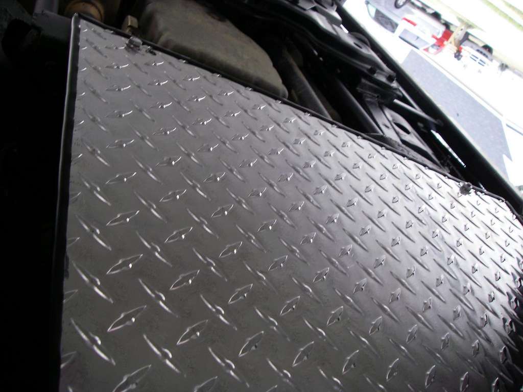

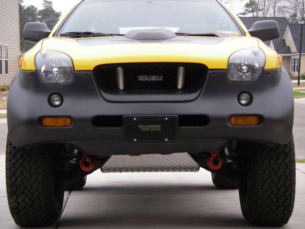

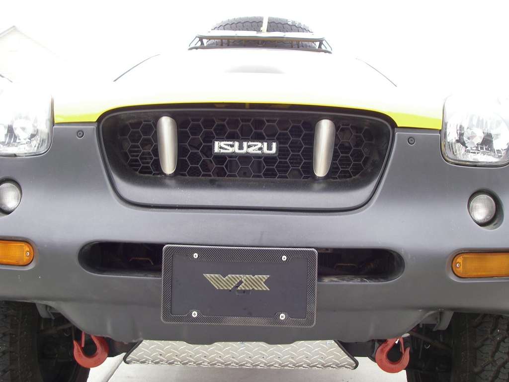

    Well, I managed to finish my 1/8" aluminum diamond deck plate for the front half today. Took about 6 hours, and I have zero metal working experience, with the exception of cutting the hole for my scoop. I didn't even hurt myself, except maybe my back. It came out great!!!!! It tucks in under the front cladding, and goes back to the first major cross member in front of the transfer case. Looks crooked from the front in the pic, but it isnt, I just can't take pics worth a damn. I also put my yellow carbon fiber Vx on the front plate today as well, enjoy the pics...
