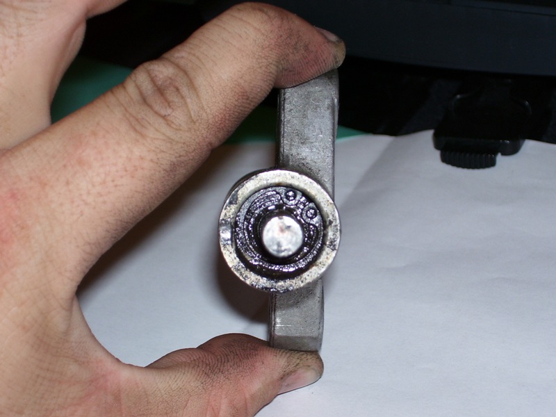

    I've been in a VX depression ever since I heard that darned knocking sound in the motor. I even warned my wife about the "potential" of the motor going kaput long ago. After reading CowboyErik's post, I felt I had hope still. Sure enough! I pulled off the passenger side timing belt cover enough to push on the belt. Without any trouble at all I was able to deflect it by almost an INCH! So, after about 45 minutes I had the front end torn apart and found that the timing belt tensioner went bad!!! I can plunge the piston with my hands with ease, and there is oil leakage around the "pushrod" base. (see pics).
    SO, IF YOU THINK YOU HAVE ROD KNOCK/ENGINE FAILURE, CHECK THIS BEFORE SENTENCING YOUR VX MOTOR TO DEATH!!!!

    If you take the timing belt covers off, you should be able to deflect the timing belt pretty easily by hand. If this is the issue, you just saved $k's!

    On the 3.2Ls, a diagnostic for the timing belt tensioner is if the knock goes away at higher rpm, above 2000-2500 rpm. But it can definitely sound like a death rattle, when my tensioner went out at Moab, everybody who heard the motor looked like they were at a funeral. But instead it was a $65 part.
