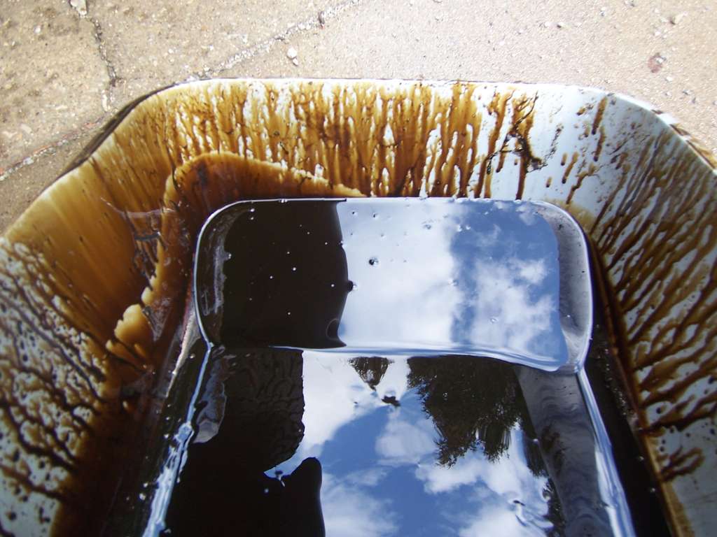

    My dip stick has never read correctly. The whole thing is always wet to the brim. I have never untill this change had any worries of oil loss. When I drain I drain into a pan (not pictured) that measures how much came out. .....
    Well....this time is a little different. I drained the oil and about ONE quart came out. I even jacked the VX up in various spots to try and get more to come out. The little oil that did drain looks to be so little that I doubt if the engine could even run on so little.
    Let me know what you think. I am confused to say the least. Is seems impossible.
    This is what came out and the filter oil was dumped here too.
    The depth is not deep at all.

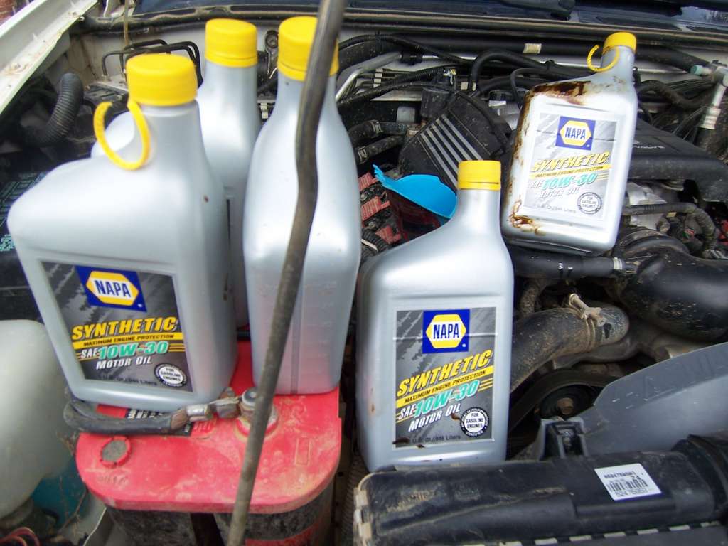

    What I put back in +1.

    You might want to change your oil change interval to something shorter just to make sure you catch things before they get this low. It's odd that your dipstick isn't reading right - since it's actually measuring the level in the oil pan, it makes me wonder if there's some big blob of "crap" in the pan or something that's causing the level to not register properly. Have you ever peeled it off and taken a look? Make sure to get a gasket if you're so inclined.

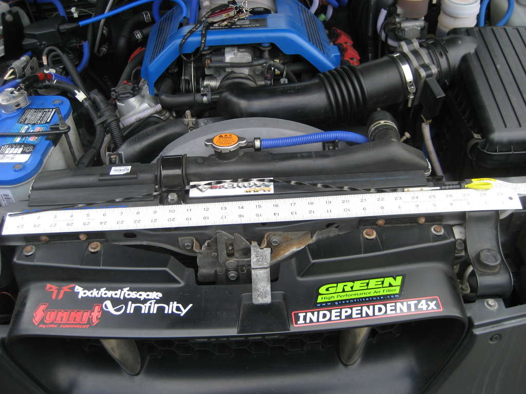

    don't get the wrong idea here, but maybe you might want to compare dipsticks with another VX owner or maybe even another Isuzu that has the same engine to make sure you have the correct length distick.

    Good points. Can someone send what their dip stick looks like. So I can compare? Maybe mine is too long. It is always wet, AND deffinately did not show a low amount for only that to come out. I think there might be some blockage. Where you would I get a gasket? Is it a simple pull off, regasket, put back on prodedure or what should I need to clean it?
    Thanks for the input. Im kinda of worried but the engine runs strong. Almost better than ever.
    J let me know if u want me to e-mail u the high res original so you can see more detail

    Just took it to the mechanic today and he cant figure out why. I showed him the pictures of what drained and the tub I used for reference and the amount was so little we doubted the engine would run as well as it does on that little. We checked all points today and could not find ANYTHING.

    Mmmmm....Hershey's chocolate syrup!!!!
    Oh, it was oil?!? That's not nearly enough...
    Me thinks it's time to drop your oil pan and see what's in there. You may want to run some lighter weight oil through with the pan removed to make sure there is no sludge anywhere else.
