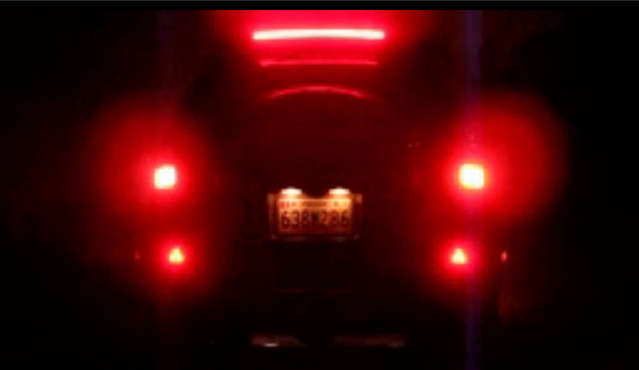

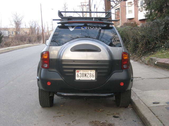

So I finally got around to modding my rear reflectors. Turned them into tail and brake lightsI'm overall really happy with the way it turned out. I went with 2.5" lights so they are a little bigger than the stock 2" reflectors
To anyone who wants to do this mod, it was pretty easy, just had to remove the old reflectors, drill holes for the new ones wiring to go through then tap into the existing wiring. The order is as follows
Ground - Black Wire
Tail Light - Green/Red
Brake - Solid Green

heres a photo of the new lights
Tail Lights
Brake Lights
