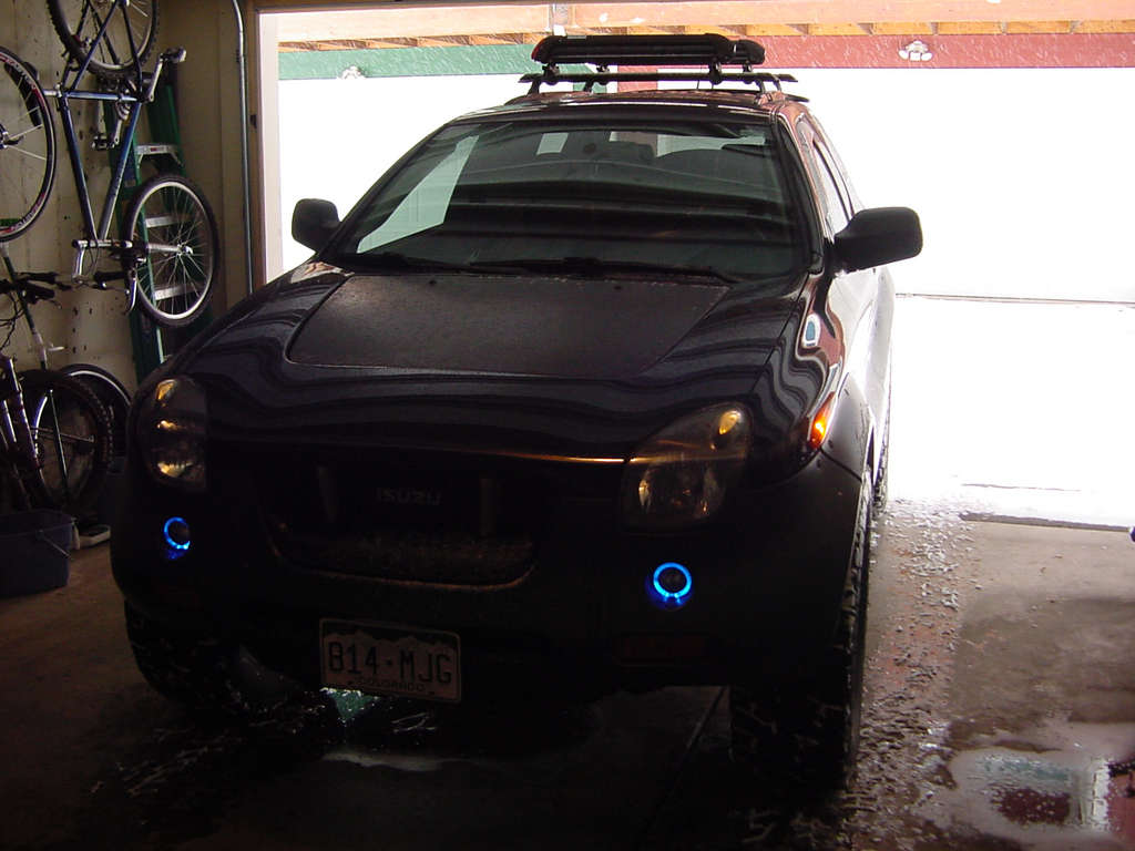

    Got to take some pictures of the angel eyes this weekend so take a look at the pictures below. It was snowing so there may be some flakes in the way, but I think you can get the picture. The angle eyes themselves are hooked up to the wiring for the old running lights, so they come on with the marker lights. I suppose that I could have hooked them up to a switch so they could come on separately, but I didn't. The fog lights ARE hooked up to a factory fog light switch in the dash (didn't take a picture of that), and work fairly well. I still need to aim them a little better, but for now they light up the road ahead pretty well.
    Hope this helps.
