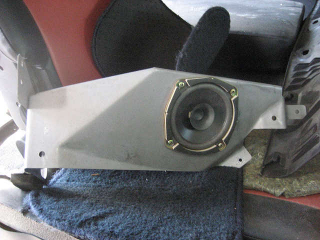

Creative FR-125's, fullrange crossoverless speaker.

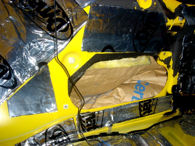

I made a plate to use the whole rear fender as a sealed box. I also stuffed the opening with fiberglass batting to dampen the panels.

1) I remember someone suggested a cheaper alternative to Dynamat called something like "Breadboard." Is there a quality or durability issue going with the cheaper alternative?
2) It looks like a hole for a 6x9 speaker could be cut into that bracket which, in my novice mind, would give a richer sound. Am I wrong on this?
