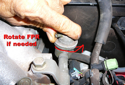

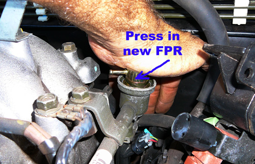

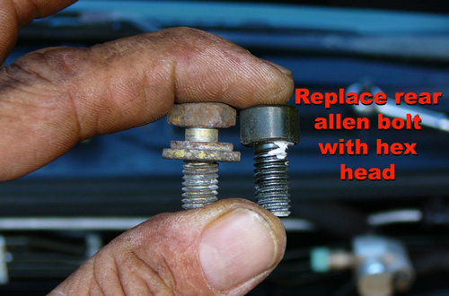

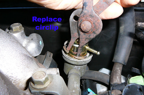

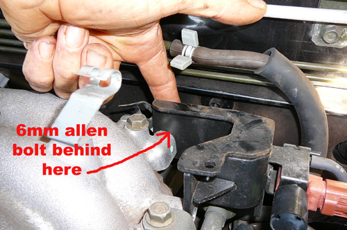

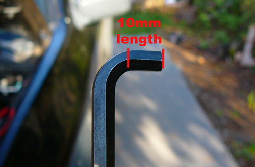

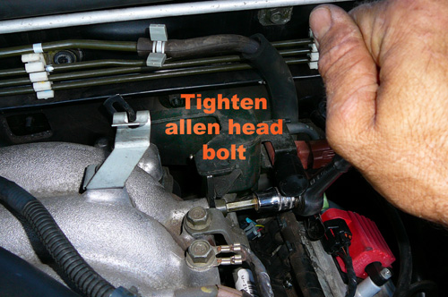

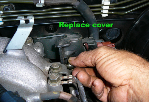

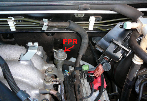

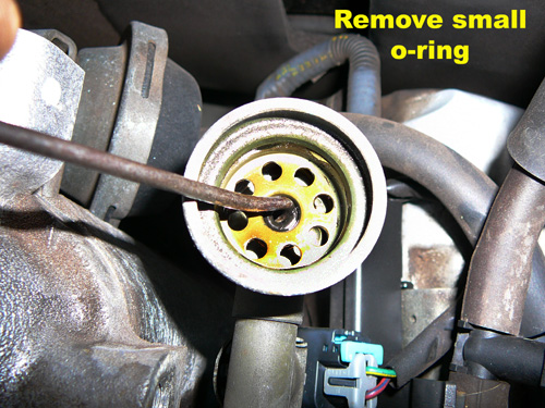

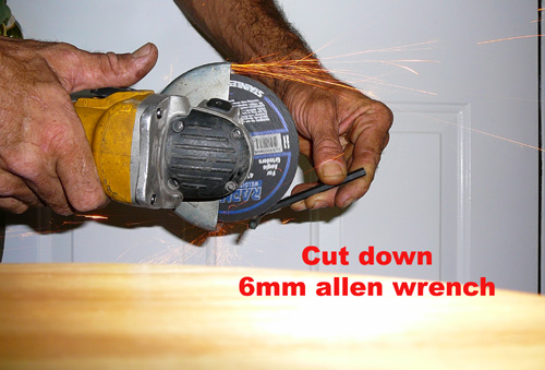

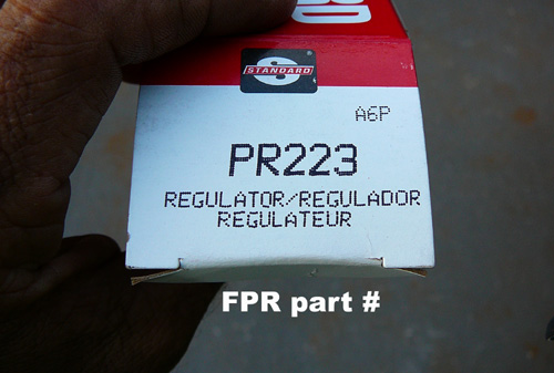

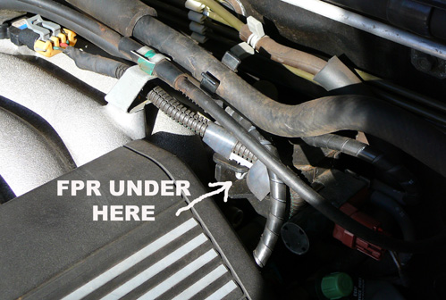

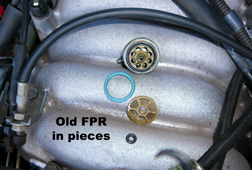

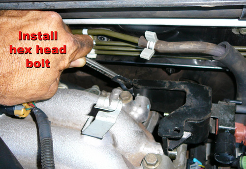

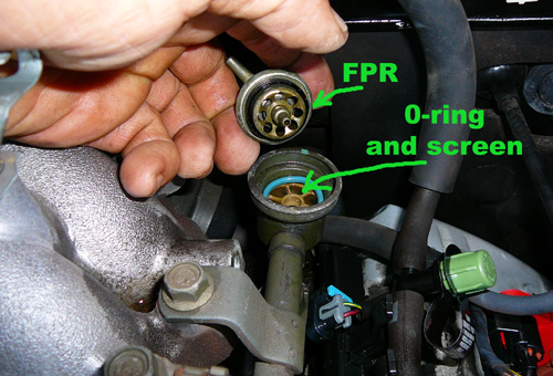

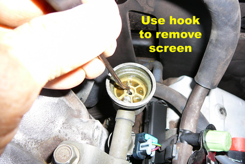

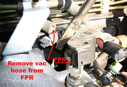

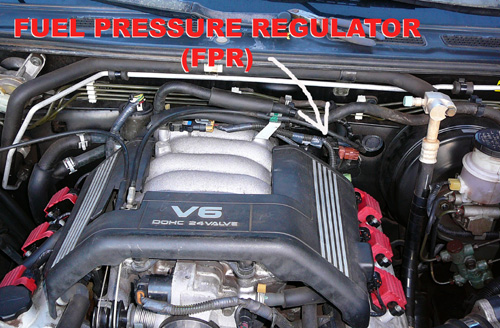

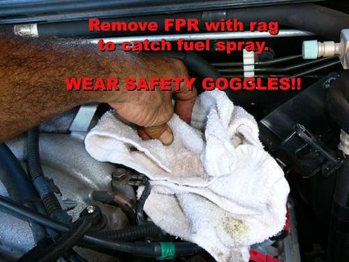

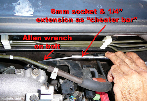

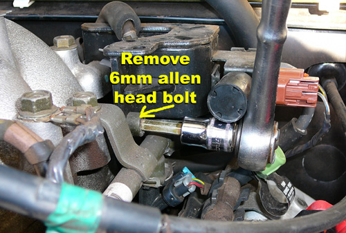

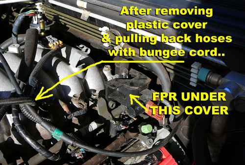

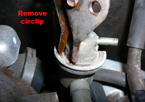

I decided to replace my Fuel Pressure Regulator. Why? Because my VX has 76K miles and I have no idea how long it's been on there. It has better throttle response now. Glad I did it!
So, I took pics and here's a step by step pictorial of how to replace your FPR.
The words are in the pics. That way, I don't have to hear myself talk.![]()
Enjoy!
FUEL PRESSURE REGULATOR REPLACEMENT IN 2000 ISUZU VEHICROSS:
