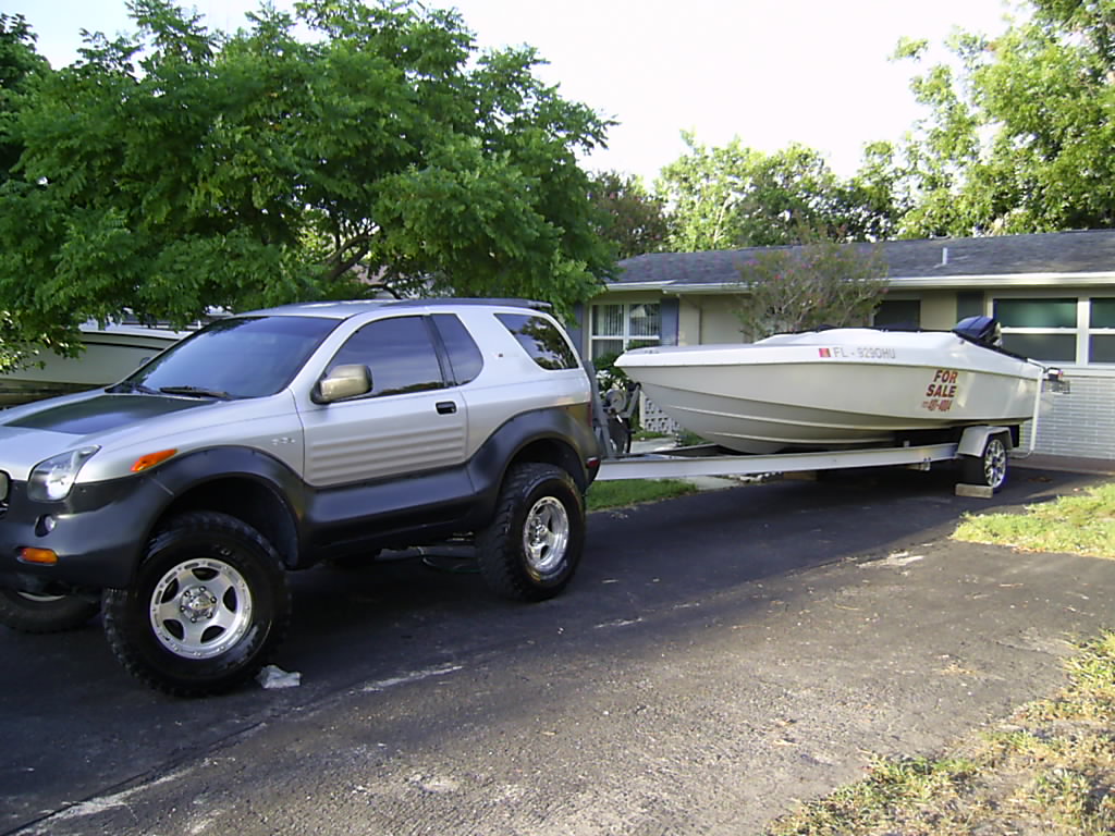

See, you cant throw up a pic of a muddy VX with a "dirty" girl. Then post a pic of a VX all shiny with a boat and no bikinisOriginally Posted by bigkoala1
next time!Originally Posted by CrnCnn
i think the truck is clean because it rained. it does that once in a while down here!
