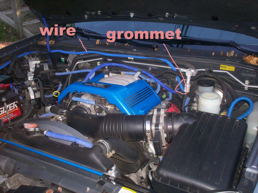

    heres how i did my stereo... there are two grommets there.. i used the upper one
    Awesome dude! Thanks for the pic. So, where do these come out on the other side? Is it pretty obvious once I get my dash trim off?
    Thanks - Bart
    yea its pretty obvious.. it comes out to the passenger side of the steering column maybe 6" up.. if you pull the grommet completely out to begin with to punch a hole in it to run the wire through.. just look up under the dash while its out adn u should be able to see light coming thru.. its pretty open infront of it
    if u run into any wiring problems let me know.. ive run wires in pretty much every nook and cranny of the vx
