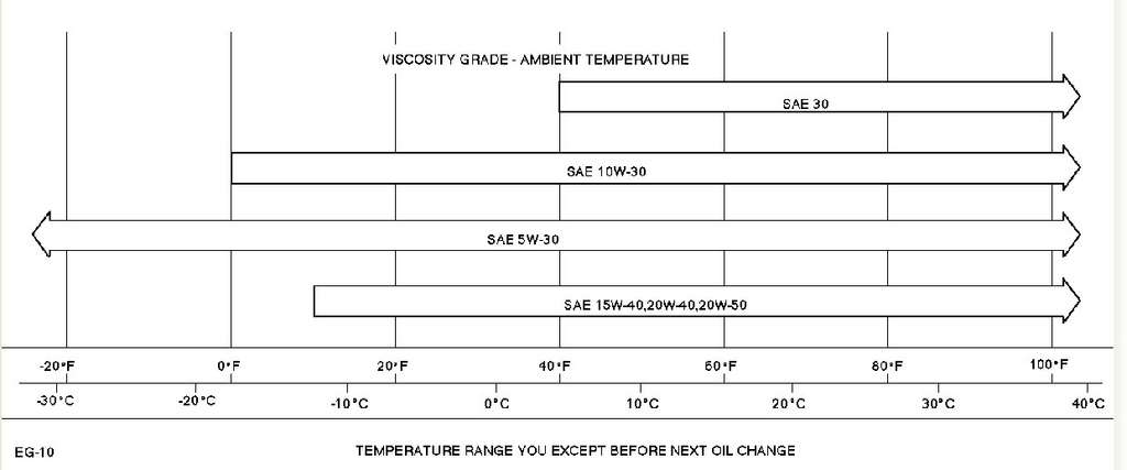

    Its almost time to change the oil in my 2001 VX for the first time since I bought it, and I was wondering what weight of Mobil 1 should I use? Should I use different weights in the Summer and Winter months or should I use the same weight year round? Thanks, Nancy
    heress the chart from the manual
    heh.. just noticed "except" instead of "expect" well done isuzu!

    I think I have gone with 5w30 from day one... Mobil 1

    Mobil 1...15W50 summer (also made the engine run quieter) and 5w30 winter

    Quote Originally Posted by etlsport
    Yeah, I won't "except" anything less than 60 degrees this winter.
