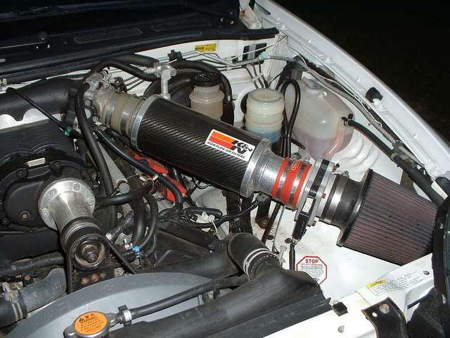

    Carbon Fiber CAI for '95 Honda Civic plus K&N cone filter. Had to shorten and put angle cut for throttle-body. Like Ldub, I drilled identical-sized hole for Temp. Sensor from SC supplied bent casting.
    P.S.---just realized that this is an older pic with the supplied air filter that came with the '95 Honda Civic CF CAI. It was the same size diameter as the MAF so I had to make an adapter to fit it to the MAF.
    I was able to replace that filter with a K&N Cone filter that fit directly to the MAF thus eliminating the adapter & 2 clamps you see in the photo.

    Cool current pic of CF CAI w/ K&N cone filter
    okay, so I ran outside and took a quick pic for ya!
    Please ignore the bugs in the filter ....I didn't have time to floss...

    Jolly Roger, is it mounted to anything in the engine bay or is it just hanging from the throttle body?

    If you look real close in the first pic, you'll see the support bracket just to the right of the s/c pulley.

    Yup...just look where Ldub said (connects from the "red coupling" to the top of the fenderwell).
