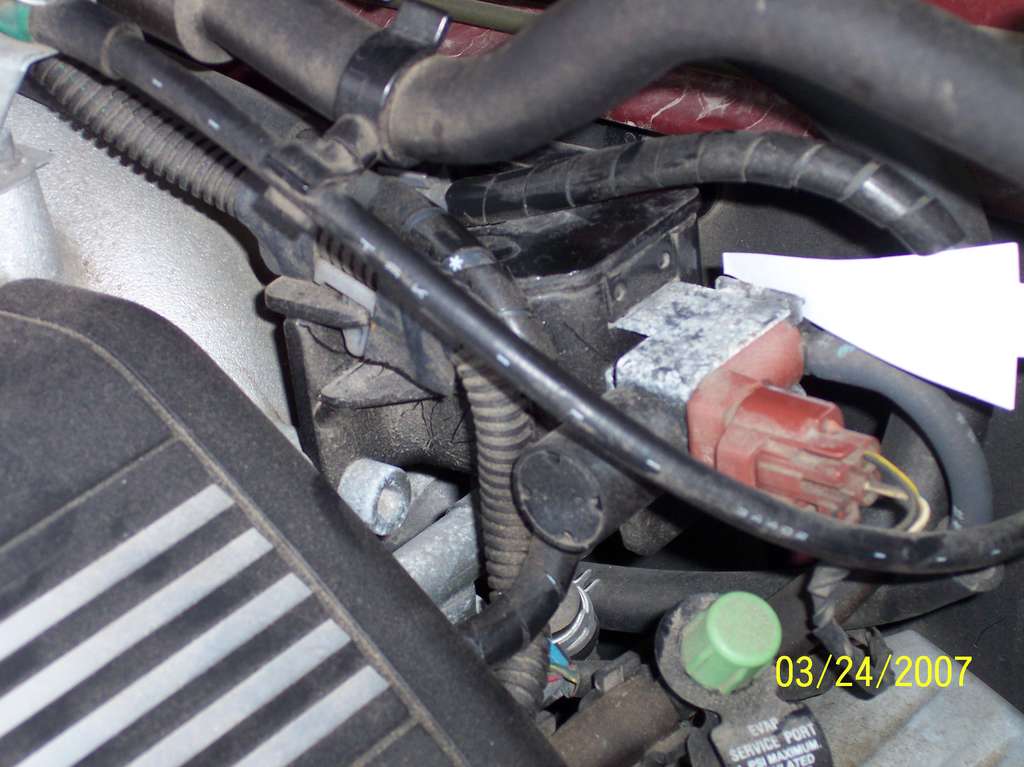

you want the can that says 134a, (the new type of freon) and one of those hoses that are probably close by on the shelf. the place you put it in is on the drivers side, close to the firewall, just aabove the valve cover. ive recharged mine, no prob.
im pretty sure that therre is even a tag that says low port ac on it, kinda light blue. i think the cap on it is also light blue. i might have a pic that ill post.
		Uhhhhh, Dave ?
That cap in your picture that is greenish in color has to do with the fuel/evap system & I believe is there for fuel pressure measurements...

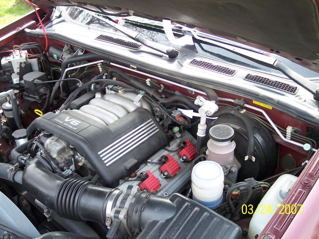

The boiq (blue one in question), is on the aluminium bloc on the firewall, above & to the right of the arrow.
Not trying to be a "knowitall", just don't want anyone trying to put freon in their fuel rail.

OH CRAP!!!!
thanks dub, ....im fallin apart. thanks for catching that, obviously, you know enough!!!
dj, and everyone else, i am sorry, for posting that and not being 100% sure, but you can recharge your a/c yourself, in most cases.
and yes, listen to ldub, very smart guy....
