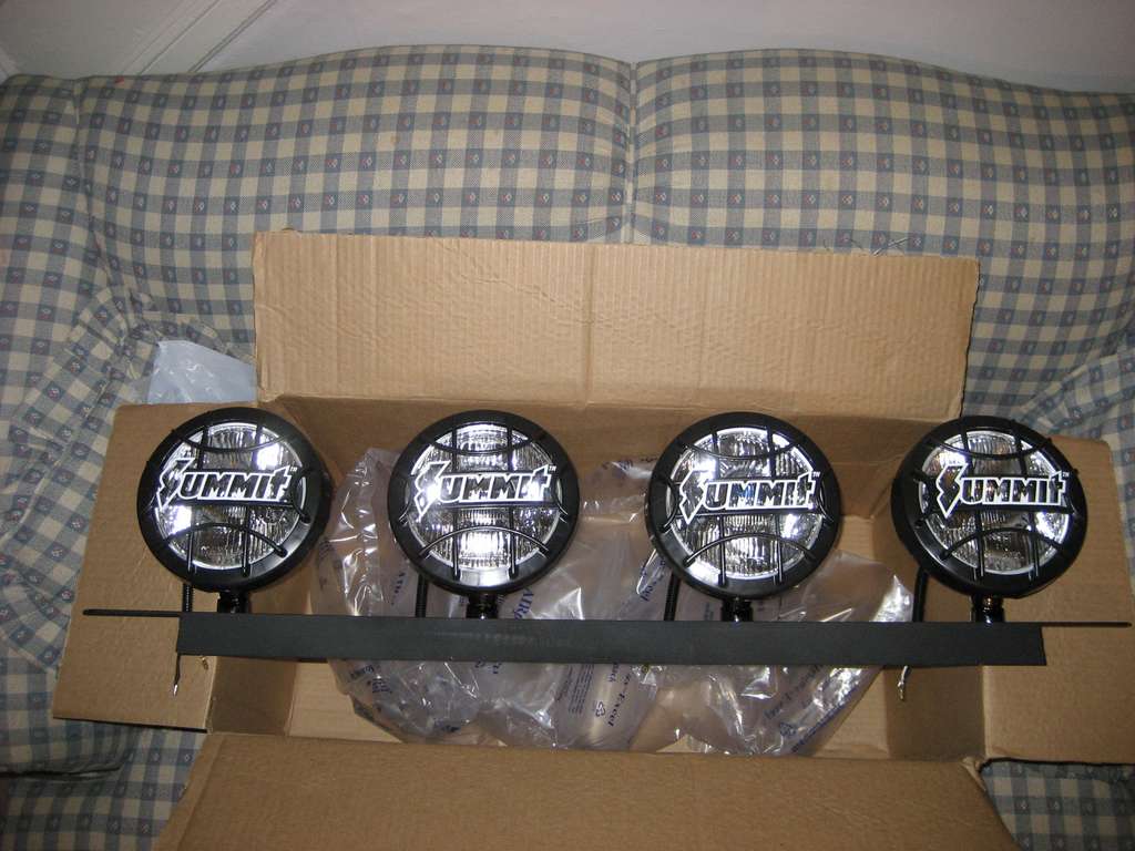

    hey bart i made a mount for lights on the coleman basket... but now i have a loadwarrior that it doesnt quite fit on.. i never perfected the mounting of it though, ended up using zip ties lol, but they worked so i guess i cant laugh too much, anyway if u want it say 15 bucks shipped?(not incl. lights of course) it sits up at the front of the basket justs behind the fairing and holds 4 lights
    the biggest problem i ran into mounting it was it had a tendency to roll forward, but i figured a threaded rod that ran down to the bottom of the basket would hold it just fine, i even got the clamps for the bottom of the basket ill throw in if i can find em
    i got my lights from summit racing, they are 100w halogen using an h3 or h4 bulb i forget.. pretty sure h3.. theyre nice though, come with a cage and all, like 70 bucks a pair i beleive

    Funny you should bring this up, since I ordered these on Fri.
    I haven't decided exactly where I'm going to mount them yet (they're huge), but they take a H-4 halogen bulb (hi & lo beam, same as stock VX bulb) & I'm planning to convert them over to HID since I have an extra set in inventory.

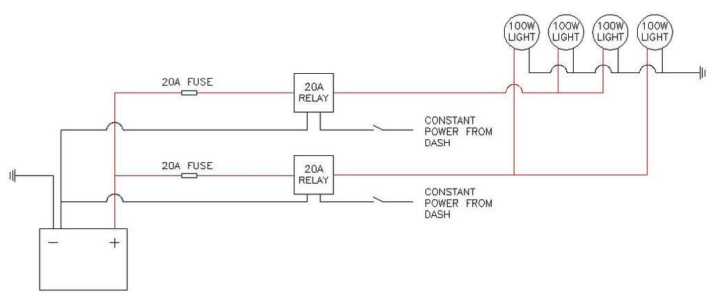

    here is the wiring diagram i drew up for my lights.. the mount that i made i used an L shaped piece of aluminum with "wings" that sit on the outside of the basket then matched the edge to the curve of the basket in the corners
    Sweet, thanks. But with your diagram here, you have to have the keys in and turned to run your lights, correct?

    depends where the constant power from the dash comes from, i should have specified, i have the distribution block for my amps behind the dash, so basically its wired directly to the battery
    the relay is there because most switches that you would want on your dashboard are not capable of handling 20-30 amps that your lights will require, so by using a relay, you will get more power out of your lights and not risk blowing up your switches, so you use the switch to give a small amount of power to the relay, which then allows the main power from the battery to flow to the lights
