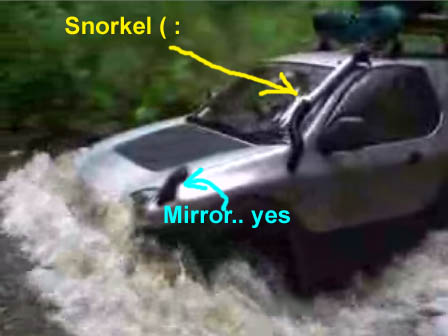

mines a right hand drive jap import when driving up river fast the water goes over the bonnet and if you have the fan on max like i did to clear the windscreen the water gets sucked down the vents and leaks out onto the left footwell and blowes the 20amp fuse under the bonnet marked as blower so keep the fan turned off when river driving i replaced the 20 amp fuse and the fan is working ok again see me in action
