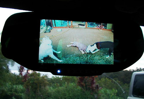

    Here it is installed! It took about two & a half hours.
    I put a stuffed toy out as bait to see what the dogs look like in it.
    I can see to within about 12" from the back of the VX. Way cool. I used it last night to paralell park in town. It kicks into night vision mode when the light is low. Everything has a greenish tint but you can see it fairly clearly.
    Love it!
    Install was easy peasy!

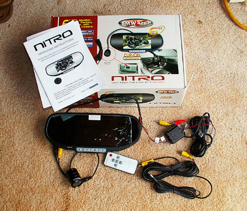

    Well, here's this shot of the kit, pre-install.
    The mirror is about the same width as the stock one. It clips on with two rubber padded spring clamps. It effectively covers the switches for the stock map lights. You loose them with this kit installed.
    I didn't like that very much, so I modded it further.

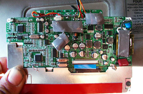

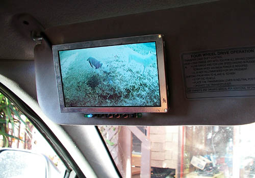

    Here's what I did to the monitor to get it to stay on the visor mirror. I put pieces of auto-trim double sided tape on it and just stuck it on!
    It should stay there for a while until I can fabricate a nice elclosure for it.
    It's hard to tell from the pictures. Is the camera wide angle enough? Do you see enough? Or is it a narrow view?

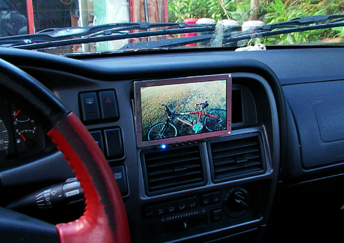

    I moved the monitor yesterday. Up on the visor was just too close to the eyes. I decided I wanted it on the dash panel.
    The bicycle pictured is about a foot from the back of VX. This will give you a better idea of viewing range.
    First I moved the stock audio head unit DOWN to where the CD changer WAS. I had to extend the wires about 18" which was the bulk of the work. It works fine there, just no more CD changer. I'll be replacing it soon anyway.
    So, that opened up the whole top DIN slot and I put the monitor there with some sticky back.( Love that stuff for prototyping. )
    It's much better in the center of the dash. My eyes just fall on it easily as I back up and look left mirror, center monitor, right mirror etc. Plus, if I ever install a DVD player, GPS, car computer etc. I can use it as a central monitor anyone can see.

    I have put the thing BACK on the visor. Just works out better there.
