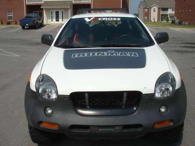

If you are not quite sure how to attach the decals to the windshield (as I wasn't). This is how I did it and it worked out pretty well.

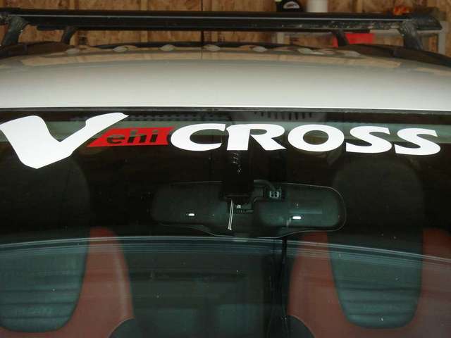

5) Place Decal in desired location, If you want it centered on top of windshield line up left side of R with the rear view mirror
6) Step back to see if it is level, adjust as necessary
7) Take your squeegee (or like item) and using firm, steady pressure rub the letters into desired location using single strokes
8) Once you have rubbed all letters into place remove the paper topper and your decal should be secured to your window, if applied properly it will have minimal air bubbles. Take a small needle while still a little moist and pop the air bubbles then smooth out with your squeegee (or like item).
9) The "ehi" is filled in with the same color as the main letters, you can leave it on or cut it out, I would try to decide before putting it on to make it easier while it is still tacky, using a razor blade to ensure it is not over lapped anywhere. We almost pulled off the middle part of the "e" due to this.
10) Stand back and enjoy the look of your new Decal!
