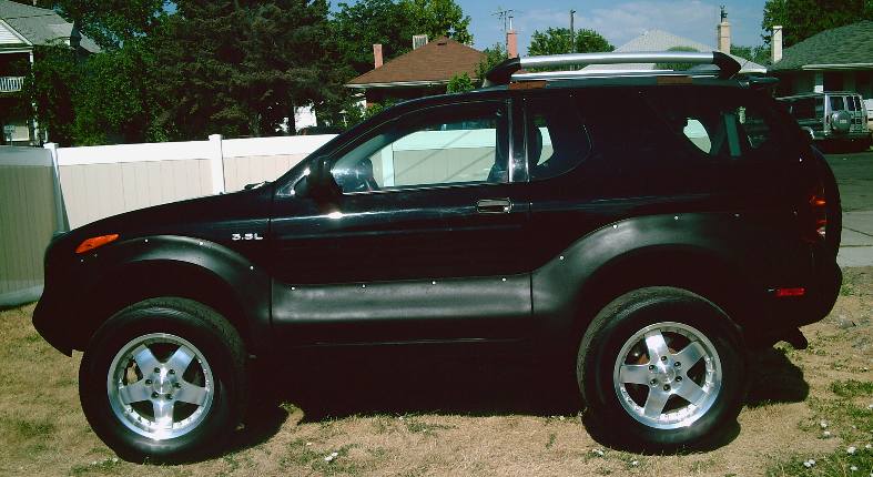

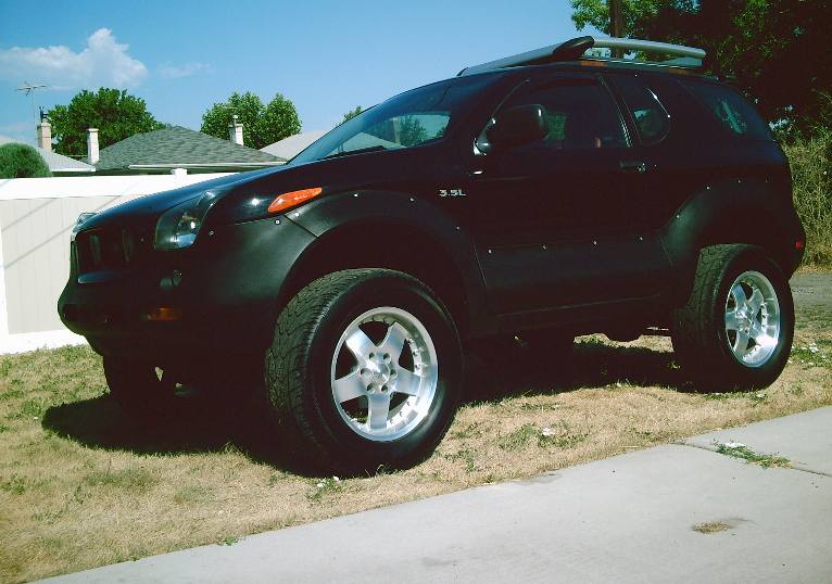

Thanks! So you know, I used 7 cans of the coating but 10 would be better. I didn't use the adhesion promoter, but I scuffed up the cladding really well. You get better results if you hold the can closer than 5" from the surface. Past that point, it seems too misty and it sometimes creates sand paper. I wouldn't go all that light on the first coat either. The cans do start to spit globs when they get near empty, so beware of the black spit! I tried to get a consistent spatter effect after it happened to me a few times, I actually kind of like the look of the globs, it adds some dimension to the cladding! Also, mask off the sheetmetal higher than I did as I got some overspray on the rear hump because of the wind that day.
So far, the coating has held up well, even at the rocker entry. I have dragged my shoes over it a few times and it doesn't even show a scuff. It seems to clean off well too... no left over bug fragments after hitting the auto wash.

Well, it's been about 7 weeks since I painted my cladding. I beautified my VX last night:
I ironically had to apply Mother's Back To Black to make the coating pop again. It did start to grey out. When the coating is applied to steel it stays black - on plastic, it seems to be another story. The coating absorbs the Mother's though, so I will see how long the cladding stays black after being "treated".
