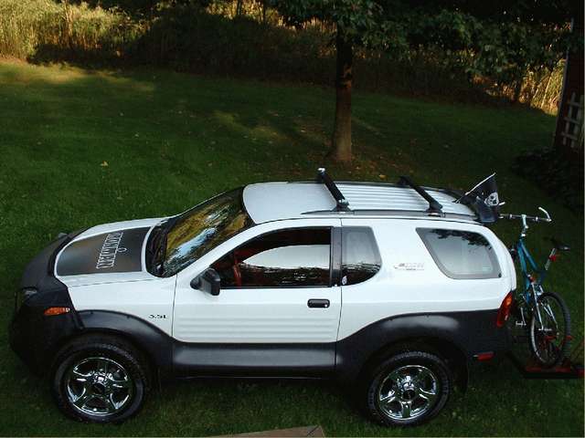

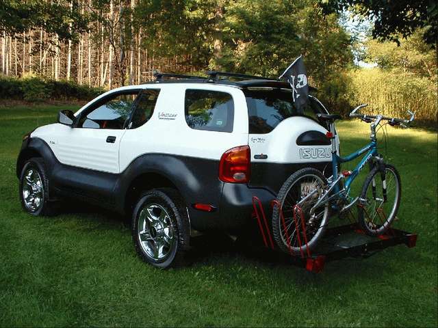

    ... or you could save ALOT of money and do this:
    especially if you're only getting a hitch to tote your bikes and you do it once every so often.
    don't hate
    May 2003
    1,220
    Wink
    I don't do any serious off-roading with this set-up; but, it works for me!
