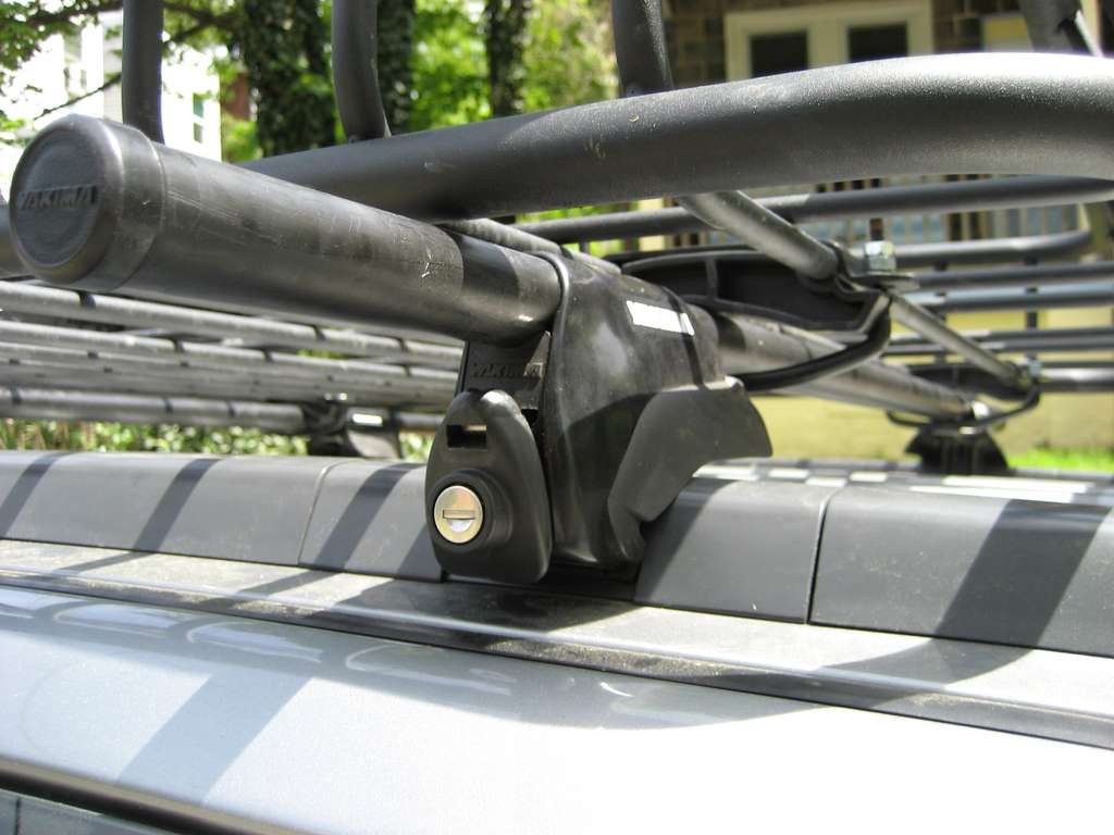

They look great!! :_drool: Mind sharing how you made them and what materials? I really need some of these to hide the shame of my hack-job roofmounts.![]()

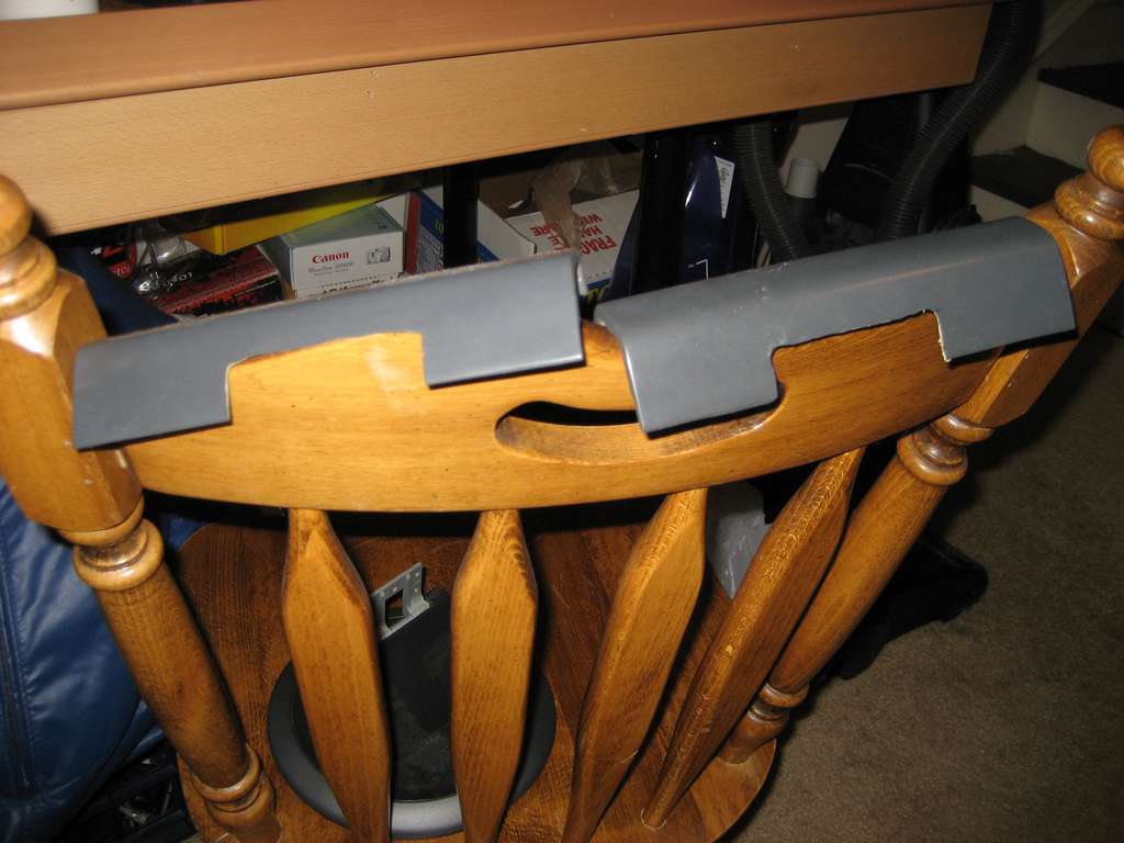

Hey, you need the stock rail covers to start, and a Dremel. Here is how I did it:

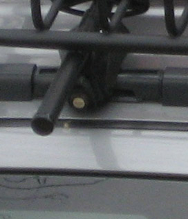

i measured up how high off the roof the opening under the rail is on each position, then took the roof rack mount i have and centered it up against the cover, marked the edges.. measured up the distance i needed to cut, drew my lines with a dry erase board marker (easily wipes off when youre done) then used the bit bart used to cut away the bulk of the material.. then switched over to this to round it off and smooth everything out
barts method probably works much better when doing more extensive cutting, mine required minimal cutting so i didnt worry too much about making a pattern make sure to test fit your roof rail covers on the roof rails and mark which goes where to make sure you dont cut the wrong cover

Hey, honestly, I would do it for you, but if I f'ed up, I would feel really bad. Not to mention, I would need to take off my roof rack and get my covers off again, which I don't want to do since I broke of of the tabs off one one of the rail covers and I don't want to risk that again.
Its really not that hard, all you need is a Dremel, which can be had for $50 at Wal*mart.

the best way i figured out to remove the rail covers is i took a small flat screwdriver and slipped it under the middle of the cover towards the outside of the vx, and then slid it to one side lifting gently until that corner popped up, then slid the screwdriver to the other side until that one popped up, then slid the cover straight towards the opposite rail (horizontally across the roof) and it just slid right off (might be helpful to put some e-tape on the underside of the screwdriver to prevent scratching the roof
