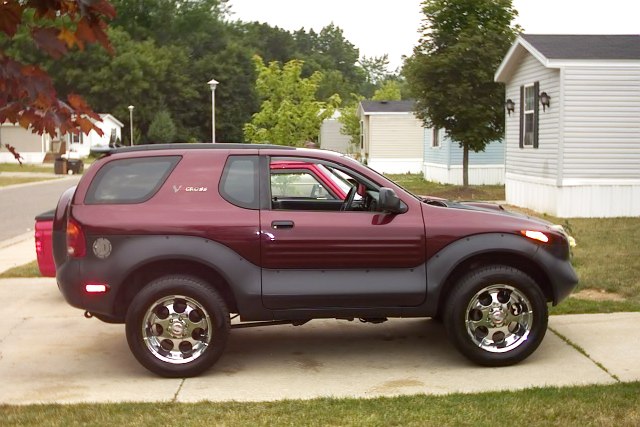

    Joe, understand your concern about trimming any cladding, I felt the same way. But, on the orginal wheel, I went with a 285/60/18 and only had to trim the front edge of the cladding and you can't even tell, and damn does it look good with the 285's. The Toyo AT is a quiet tire, aggressive looking and gives the VX the look it deserves. And if you cranked the bars up to level the VX out, you might not even have to trim at all, or very little.
