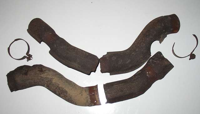

    So my VX has been rattling something awful ever since I had the new muffler installed. (Yes, the muffler resonates that much!) After much exploration by the friendly folks at my neighborhood Firestone shoppe, it was determined that the rattling was coming from the heat shield.
    Furthermore, I apparently didn't even HAVE a heat shield...but rather, a heat-shield-shaped rust shell. It was in awful condition. The upper and lower sections were basically a crumbling mass of iron oxide chunks. They removed it, and it was just flaking off into pieces. Thanks, Florida!
    Anyway. Long story longer. What's the dealio with these heat shields? Should I try to replace it with either a new one or a salvage one? One with less rust, this time? Or is it no big deal? I mean, mine was in such bad shape by the time it was removed that I might as well have had nothing there anyway.
    Is it okay to drive without this heat shield, or will my VX explode? (And why do all of my problems end up with the VX exploding, in my imagination?) At least, without the rattling heat shield, my ride is much quieter now! Right up to the loud explosion, at least...

    It's a two-piece, rusty, rattling wrap-around cover for part of the exhaust pipe. Passenger side of the engine compartment.

    OK, this morning I ripped off what was left of my big long passenger side sheild. It drove me nuts all the way to and from Moab.

    Bart, if you can believe it, the remains of MY heat shield looked much worse than yours!

    Want a mechanics input... well here it is anyway!
    Heat shields are there to protect things surrounding that super-hot exhaust pipe! It's fine moving down the road with air rushing by, but when a vehicle gets shut down with a super-heated exhaust, the heat rises and super-heats your floorboards and other bits that are nearby that don't take well to repeated, intense, heat!
    It's best to try to keep them on.
    If they're rattling, any competent muffler shop's welder-on-duty should be able to tack weld them back in place.

    I'm definitely not the only one on this apparently, after I got mine I was very annoyed at the rattling that would happen when the car was idling, I traced it down to the heat shield and the u-bolt (right term?) had rusted, the shield wasn't in great shape but it was mostly there and I simply replaced the bolt so it wasn't sitting on the exhaust pipe, simple enough solution but sometimes I fear looking underneath my VX b/c I see a lot of rusty looking emissions equipment that soon looks like it will need to be replaced....
