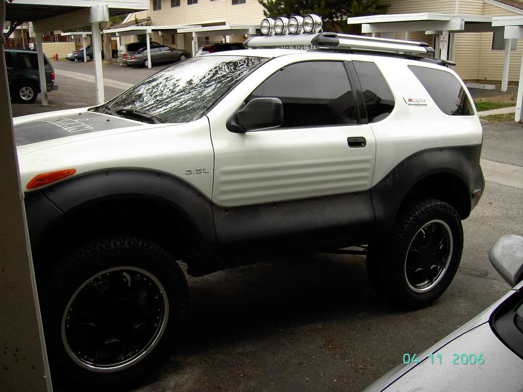

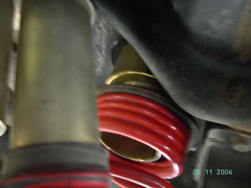

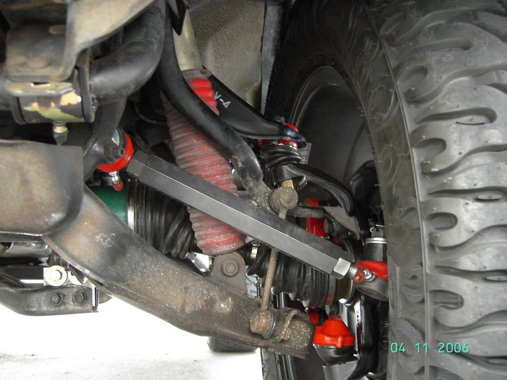

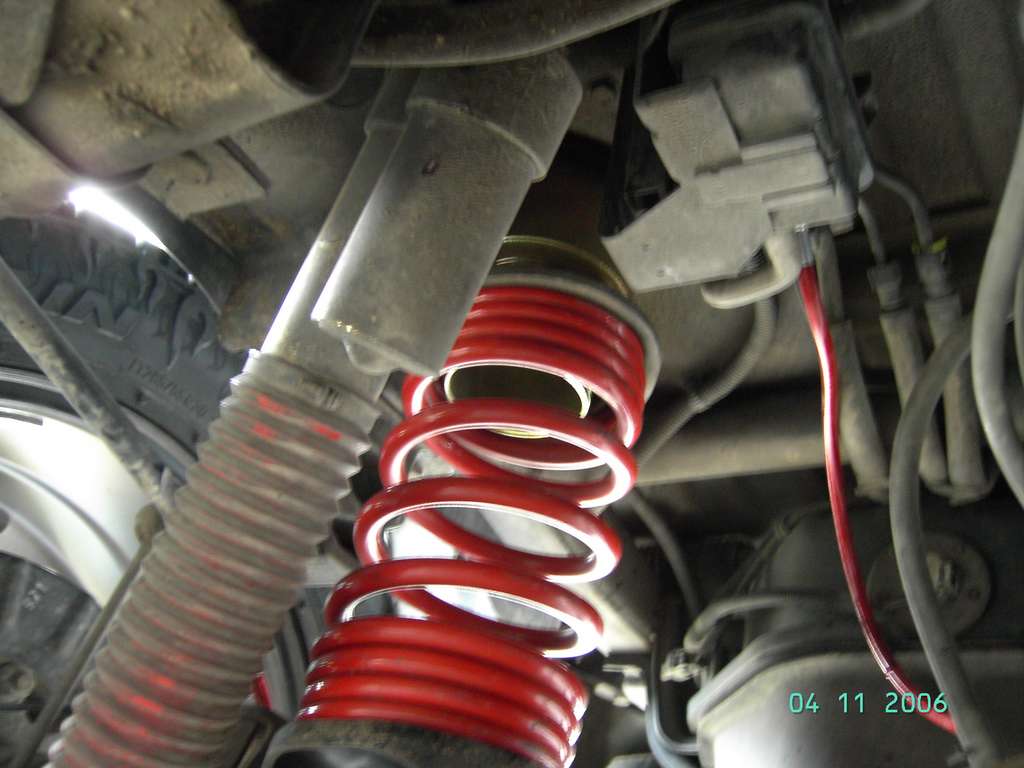

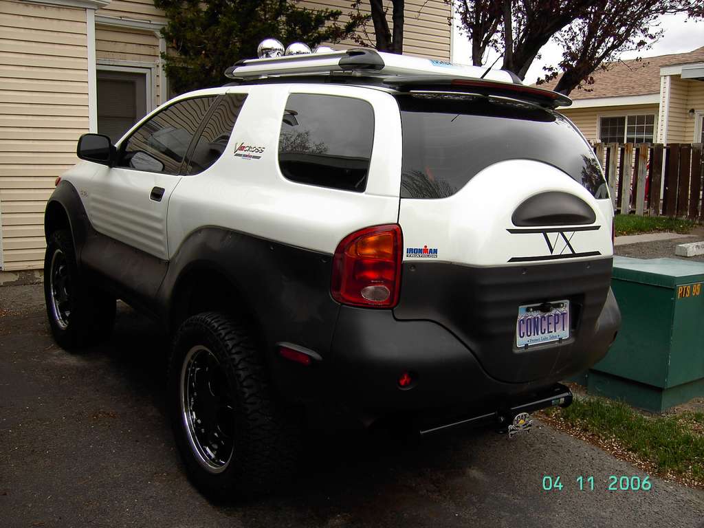

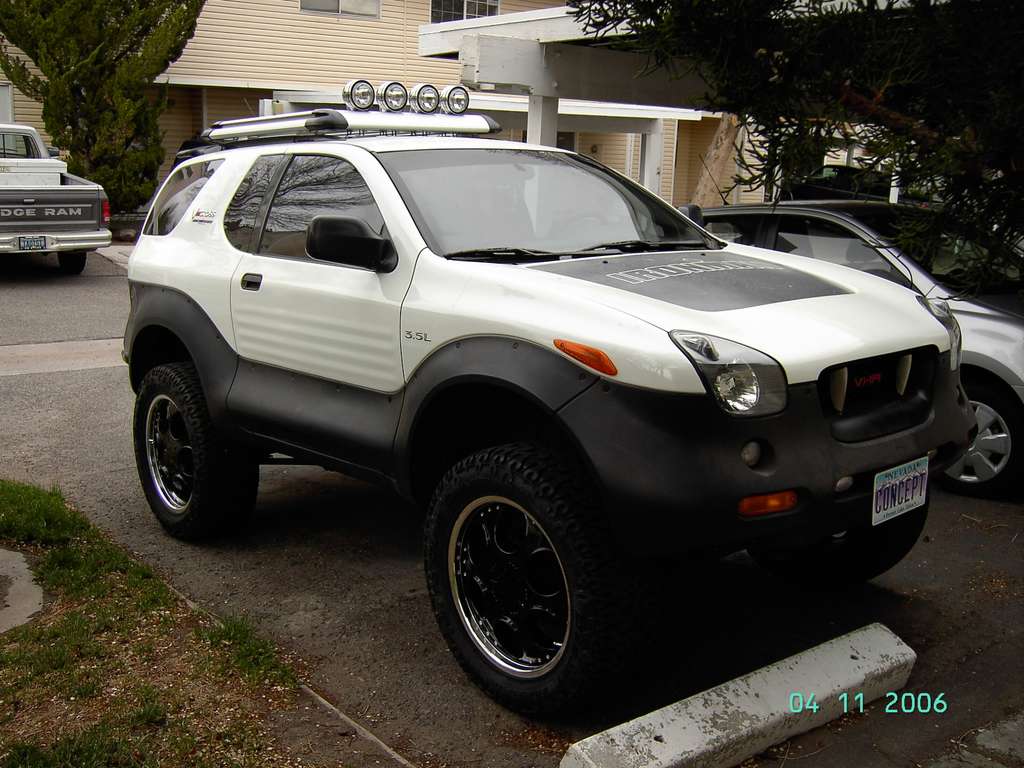

    So, the VX has been down for several weeks while I tore out the front end to get at the differential drop brackets to lift it. Long story short, a lot got done to the VX, like:
    2" extended diff drop brackets
    1.5" drop brackets for forward frame cross-member(under forward driveshaft)
    New inner bearings and seals
    Mecatech CV boots
    Brand new upper and lower ball joints
    Ball joint flip
    Independent4x brake lines
    Brake caliper speed bleeders
    Energy suspension polyurethane low profile bump stops
    Energy suspension polyurethane tie rod dust boots
    Custom made 1 1/4" Powder coated 4340 Hex tie rods w/grease-able rod ends
    Energy suspension grease-able sway-bar bushings
    Re-indexed front suspension to 4" of lift
    Installed Nitrided steel spring jacks in the rear for 4" of lift
    Energy suspension polyurethane coil spring isolators
    4 Mega 835 20" rims
    4 Nitto 285 55 R20 Nitto Dune Grapplers
    Aisin Locking front hubs
    Brakes flushed and filled with ATE Super blue brake fluid
    Front and rear differentials changes to Mobil 1 full synthetic
    Oil changed to Mobil 1 synthetic
    All bearings/bushings lubed with Red Line CV-2 synthetic grease
    All brake parts and ball joints painted with Hi-temp red ceramic paint
    Here's some pics, Sorry about the bad lighting, but it's overcast outside. The guys at the alignment shop said their machine can't hook up to that rim size with the Nittos because the bead is too tight. So tomorrow, I get to take these of, put the old ones back, have it aligned, then put these back on. So far though the ride is nice and smooth. I love being up high, and man, I thought people looked before, but now I think I might cause an accident or two.

    Hey Cyrk, the part #s are
    Low profile bump stops: ENS-9-9102R
    Ultra Low profile bump stops:ENS-9-9132R (I didn't use these, but probably should have due to the increased lift)
    The coil spring isolators are ENS-9-6101G but unless you plan on using the type of rear lift I did, or want to replace the factory coil spring isolators I don't think you'll need them.
    I don't have the part numbers on hand for the tie rod dust boots, but they are fairly universal and can be found on the Energy Suspension website. You wouldn't really use these anyways unless you have Heavy duty tie rods, since the OEM tie rod ends are sealed units.

    I was about to ask you the same thing!!! I haven't seen CrnCnn around lately either. The VX is back at Tires Pls this morning getting aligned with the stock wheels, then I have to throw the Dunes back on(30 minutes). After that I'm good to meet up anytime. I'm thinking Big Pig BBQ, but wherever is fine. During the week I have all day, everyday since I work very early in the morning. I am almost thinking of dropping it down a little because at the present height, I think the wheel well clearance is a little big, but the only plus side is that I have had trim barely any cladding at all, maybe around 1/8 of an inch because it rubbed when I was turning and going up a curb.
    Looks great! Did you change out the shocks as well? If so to what?
    No shock changes, which on the rear I am slightly worried about. I am going to try and fab up some aluminum extensions for the rears, and some steel post extensions on the fronts. I had purchased some front post extensions, but they were the wrong thread pitch. I ahven't been able to find any of the correct pitch yet. I like the stock shocks, and I think there was a post I read awhile back about a way to rebuild them, or a shop that could, so I may look into that when the time comes.
