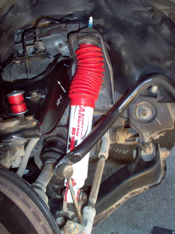

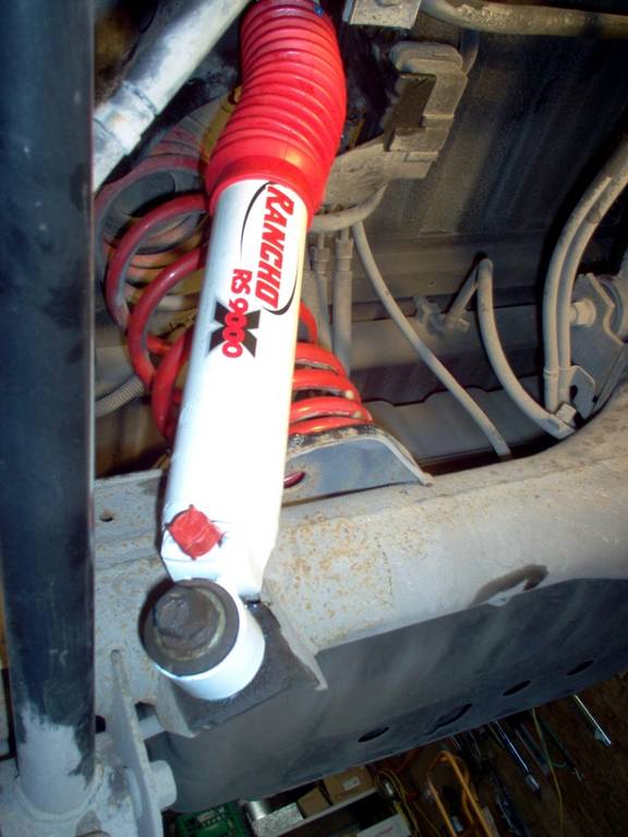

    Here's a few picks from my install.

    Thanks Kenny! Thats all I needed to know and then some! Also thanks for the picture reference!

    Kenny, I noticed you have your front shocks mounted with the adjuster UP. Isn't that hard to reach? I have mine down, and easy to reach through the lower A-arm. I spent this week comparing the difference between full soft and full hard, so getting access to the adjusters was important. Handling really improved once I reached setting 6, 8 was a little firmer, and 10 was a bit too stiff for comfort. I'm going with 7 or 8.
