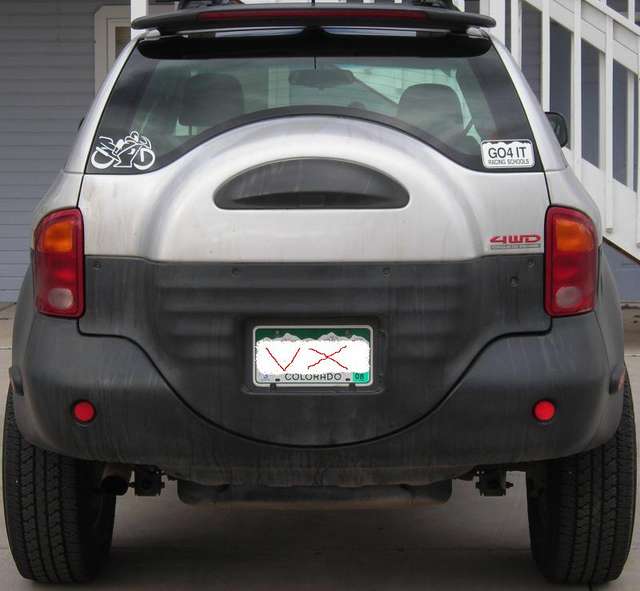

JHarris: Keep in mind, because I have wheels with a small inner bore hole, I had to use 2 1/4 inch spacers to clear the hub....since the tires sit out further, there is a much bigger problem with rubbing when turning the wheel....that means cranking it to ride a bit higher and more trimming than usual....pain in the arse, but I like the aggressive stance. I'll see if I can snap a pic and post it shortly......

Here's the piccy with $1.88 worth of Starbucks running down the door. the wing makes a great coffee holder when loading the VX....just don't forget and drive off.
