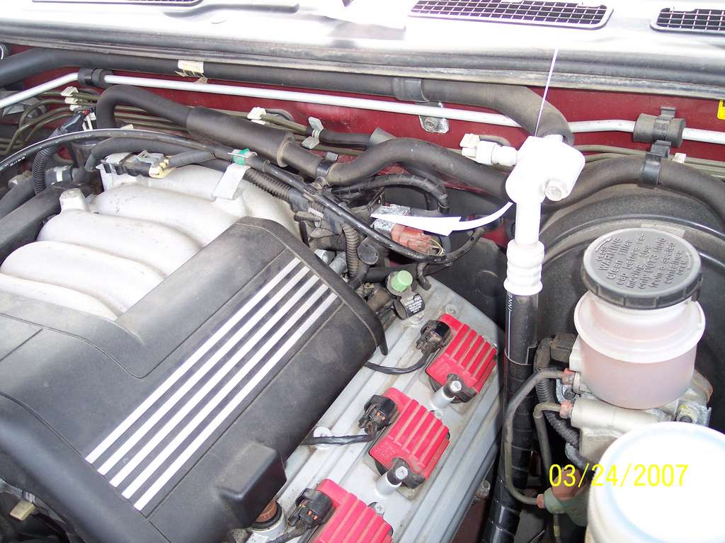

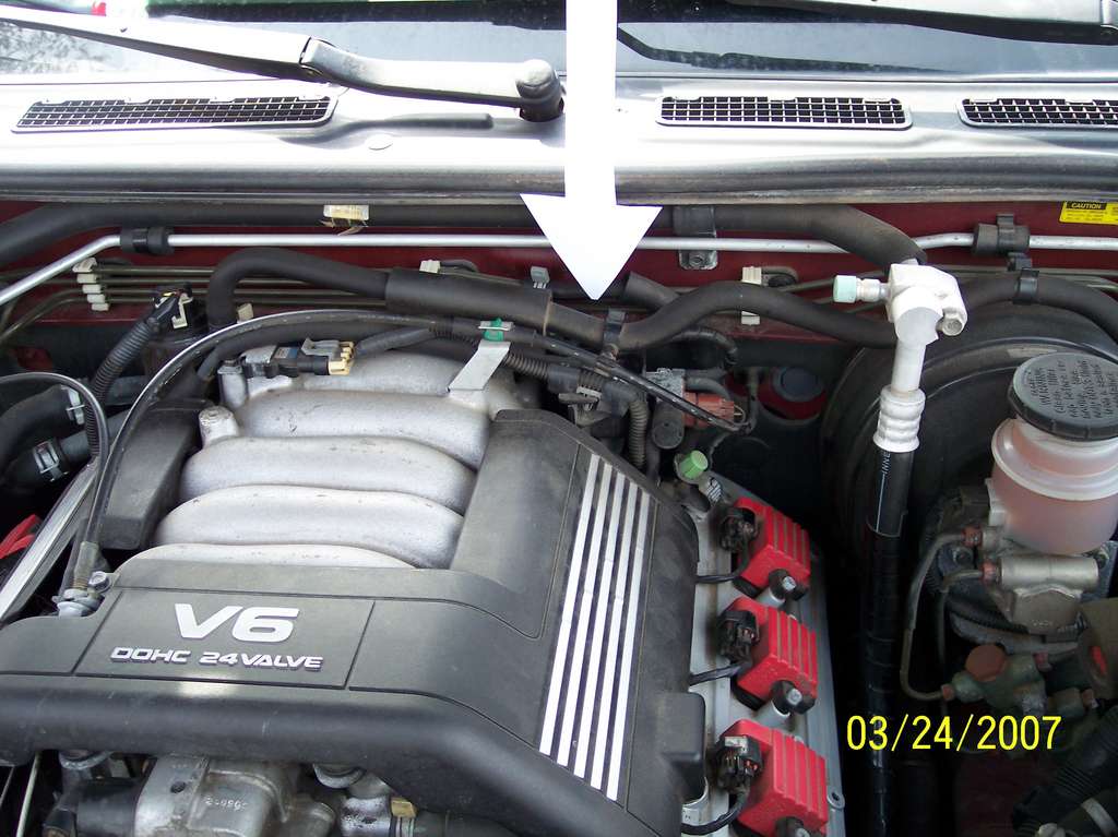

  14. #29
    Mar 2006
    2001 FOXFIRE 0579
    887
    Ok, got some pictures, with homemade arrows even...... please, excuse how dirty my engine compartment is, been working at a place with a long gravel driveway.....but its warming up, and i promise you, i will have it all nice and clean again
    back to the matter at hand.......the noisy black box
    this is the general location...drivers side, back, etc
    here you can see the black box, right behind the oxidised silver clip. what is this thing??? government tracking device that uses morse code? what ever it is, i am getting alot of tapping noise from it, and has anyone else had this thing do this??
    have at it buddys, i dont have a clue. also, it doesnt seem to tap when the engine is cool, or cold, but after the engine warms up, the tapping is constant, and kinda decreases with revs.
    thanks guys, i really appreciate it!!!
    david
  15. #30
    Arrow
    Near as I can tell...that would be your fuel pressure control valve.
    Take a look in the shop manual that Scott recently made available for download & look under "fuel system".
