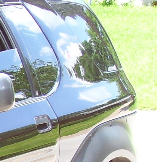

    By request: here are a couple of quickies:
  1. installed Rancho 9000xls and a 1 1/2 lift. What a difference!!!
