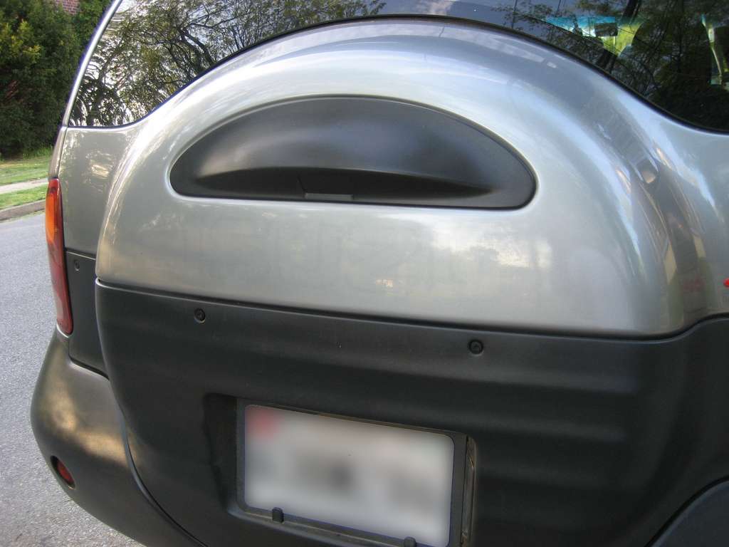

    So I was wondering the best way to take off the "isuzu" lettering on the back of my vehicross. I started with a razor and felt like I was scraping the clear coat and stopped. is that the only way? Any tips?

    Make sure it's warm. I used a hairdryer set on low. Peeled a corner, then used dental floss to separate the glue from the finish.

    Yeah, you definitely wanna do this in the summer. I used the hair dryeer and floss trick. I would not use a razor. Get ready for some serious cleaning after too. You will end up with an outline of the logo when you are done. Use a clay bar kit to get the remaining gunk off the back, and then wash the VX really good. Once you are all clean, a good waxing will usually help get rid of most of the badge clouding. This spring I am going to take my VX and get a complete top to bottom detailing. I can't wait.

    Thanks Chop, I just looked and mine is 3M in about 14oz can, I dont recall it being too expensive either and I remember it doing the job quick.
    I just did it on my silver VX.
    I bought a heat gun, but hair dryer will work.
    I heated it up just a second or two, didn't get hot, just warm.
    Then used a plastic putty knife ,to push it up.
    It came off so good I saved the letters.
    It took only minutes
    I did my black VX different and I had to use a buffer after them mess I made.
    I just did my wheels too, I was dreading doing them because it was such a pain last time. So I did it different this time.
    I took the caps off and then used the heat gun to where it started melting the plastic sticker up and then I used a rag to pull the edge and it comes off in one piece. Then I set the caps up and used starting fluid to sit on the glue and after a couple of minutes used the plastic putty knife to take up the glue.

    Thanks for all the responses...I did not get too far with the razor...just about a 1/4 inch of the corner of "U" in "Isuzu". I like the idea of people not knowing what brand of car I have...Let 'em think it's a concept BMW..it's our little secret right?
    debadged today.. used a hair dryer and a plastic spatula, worked like a charm.. just a small warning though, there will be some letter "shadows" left behind mines an 01 that is very often washed and waxed
