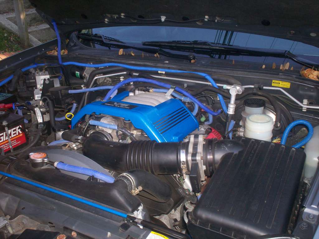

    Can you post pictures of what you have done? Isn't all of the wiring already done in black?
    Henry
    yea the wires are all done in black already, i want to go back and do it all in blue
    to clarify, im looking for suggestions as to what companies/brands make a good quality loom that will hold up to the heat

    Check www.cableorganizer.com. They have colored corrugated split loom good to 200F. Panduit, an OEM, has some good to 230F, but I think it is only available in black or grey.

    Just an idea, but I used silicone tubing when water cooling my PC which was a translucent blue and supposedly many types of silicone are good clear up to around 400 degrees or more and it never really fades with age, just gets somewhat cloudy. You could buy it in different diameters and slit it just like the coverings you are now using. Silicone is already used in engine compartments as well for many types of tubing and is good in it's insulative and cleanability aspects. Here's a link
    http://www.crazypc.com/products/cool...irs.htm#tubing
    it's the primoflex, and even though it says it's PVC based, it is just like silicone. They used to have an even bigger size, which I got that is around an inch diameter. It's been in my PC running hot water through it for over a year now with absolutely no problems whatsoever.
