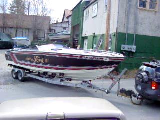

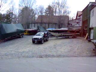

i posted some pics of the dalan hitch way over the rating of 3500 lbs .you tell me if it is a poor design.looks very weak to me ,gonna break any second.

Holy Cow!,, You pull THAT with a Vx?
just around the yard at work.that boat weighs at least twice the supposed 3500 lb limit of the hitch.in my opinion it is a very sturdy piece and if i ever get the vx stuck i wont think twice about putting a strap around it to get pulled out. shawn
