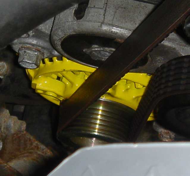

    1,256
    Will Alterstart powdercoat them so they look purdy like the one Hotsauce has? Was that extra or did that come included in the $269?
    1,330
    purdy colours....
    Quote Originally Posted by kpaske
    The powder coat with with Mr. Alternator was extra ($25 - 30). I didn't ask Alterstart about powder coating.
    -biju.
