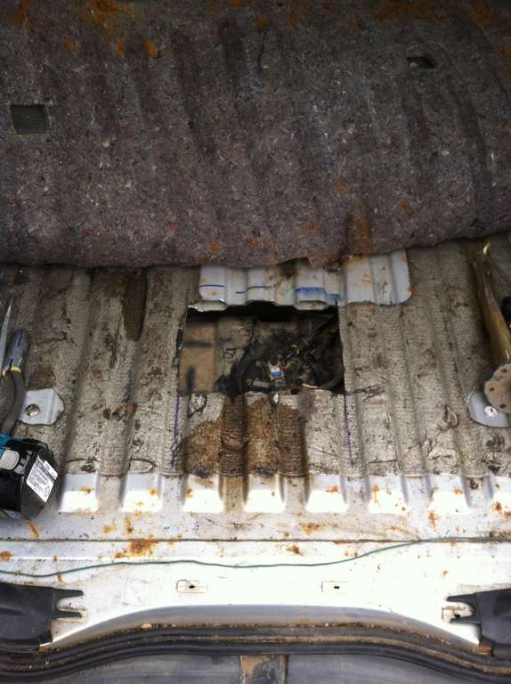

    Went for a haircut and she wouldn't start afterwards. Appears to be a fuel pump issue. I don't hear the pump at all and I pulled the line going to the filter and had someone crank her over - no joy. Fuse OK and I swapped the relay with the starter relay - nope. I jumpered out the relay connector pin according to the manual - negative. I am going to have a buddy tow me in the AM, I just hope it doesn't get towed in the meantime. I am considering cutting an access hole trough the rear floor, I saw that JPuga87's ride had this done but from the pictures it looks like the wrong spot. Thoughts?
    http://www.vehicross.info/forums/sho...8&postcount=19
    01, LineX tan/black, 1055
    3,380
    You should be able to follow the wires to the top of the tank and feel by hand where it is from the rear and the side. Kind if eyeball the location from above and cut a small hole to get started. I need to do the same on mine as I carry an extra fuel pump on the trail. On the Planet, I am sure there is a thread about it there. Get yourself some silicone and some aluminum angle so you can make a new frame and voila, easy access to the fuel pump forever!

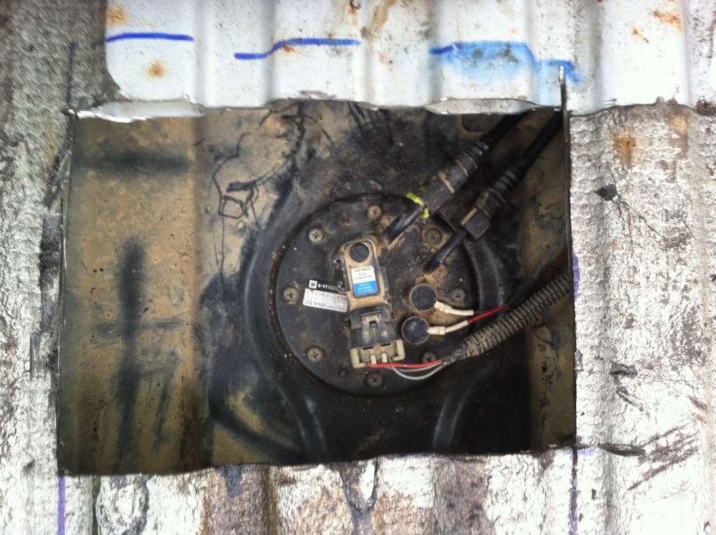

    Well, good news all around. My VX didn't get towed over night and the parking lot I was in includes a CarToys. The guys there helped me push her a little closer and let me plug in an extension cord for my angle grinder. Since I have a '98 Trooper parts car I was able to cut it's floor board first as practice and measurement and to get a free replacement fuel pump. It also provided me with a patch piece for the access hole in the VX. The Trooper was much easier to cut but I was eventually able to get the VX done too. This hole makes it so easy to replace the fuel pump! Once replaced she started right up.
    Not the cleanest cut but functional.

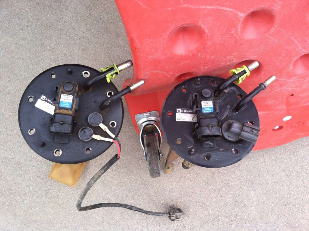

    Interestingly the VX pump assembly is a little different than the Trooper. The pump voltage feed is hard wired at the VX pump and the Trooper has a connector at the pump. Both have another connector attached to the side of the tank. I used just the pump from the Trooper until I got my VX home and then switched over to the entire Trooper assembly. My original assembly had a bit of corrosion on it so there may be a tank swap with the Trooper in the future. You can tell this wasn't originally a Colorado car...

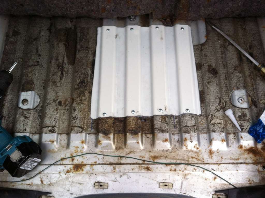

    Some RTV, self tapping screws, and the patch plate removed from the Trooper completed the job.

    do you remember the distance from the back door jam or where the seam is?
  13. #13
    3,380
    Billy, this should be easy since my rear is empty, we can measure from the end of the factory floor coating. I want to do this on mine as well, we can experiment with mine, then do the final on yours.

    Went ahead and cut the plate in my truck. Cut it too small, had to take another piece out. I welded those back together. I ahve about an 1/8" of herculiner back there, so it was hot enough to be melted under the outer shell, just pushed it back into the weld groove with a chisel Never know it wasn't one piece from above. Billy is picking up some steel so we can make the brackets to hold the final plate in. I will seal it with RT and then touch up herculiner over it. I may pull all the what were once phillips head screws. They are rusted pretty much flat. Rather do it now than on the trail
    Not a terribly hard project and will save LOTS of time if I need to swap the fuel pump one day.
