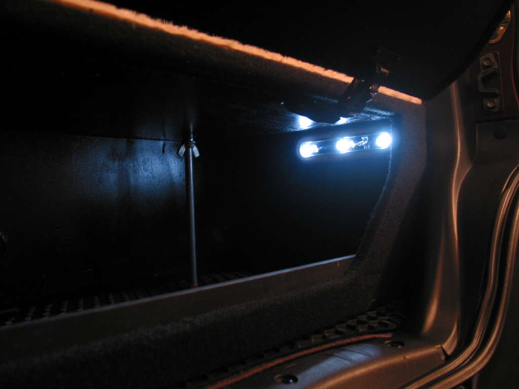

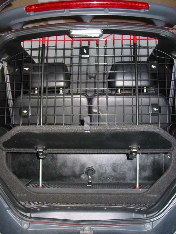

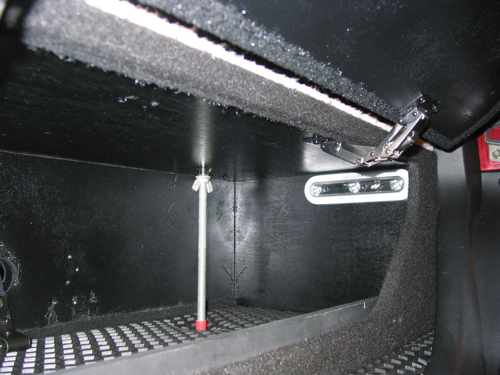

    So one of the problems with this set-up is that you either carry the dog in the back, or cargo in the back, but not both. So when Grant put his Tone cargo box up for sale a few weeks ago, it gave me the idea you see below. I drilled two holes in the box for the barrier's support posts (measuring was a @#$%! as the top of the barrier only has a 1/2" margin for error to fit on the ceiling liner), added a cross-support on the left side of the box (don't think you can see it in the pictures though) to increase stability under my dog's weight, and added one of Dub's now famous LED light bars to illuminate the inside of the box at night. Originally the interior of the box was unfinished wood, so I also rattle-canned it black to match the exterior.
    The structure is very solid - the box can't go anywhere because the bottom of the barrier is pressing down on it, and the barrier can't shift back and forth because it's now attached to the box. The only thing I would change would be to cut out a section in the middle of the barrier so I can reach the rear seat release easier. But that will require careful consideration of where to cut without weakening the wall too much. Probably something I'll fiddle with this weekend.
    I'll have to take another picture of all the stuff I have crammed in the box already: Fix-A-Flat, WD-40 (step bar rattle), Silicone Lubricant (window lubricant), quart of oil, air compressor for tires, tow strap, California car duster for interior and exterior, first aid kit...

    Agreed that this would be too small for many dogs, even ones smaller or the same size as mine. As I said in the original thread, she just happens to be really comfortable with small spaces. Still, I'm hoping that by cutting the lower third of the center section out of the barrier I can give her more room to turn around while making it easier to reach the seat latch.

    The barrier consists of two sections, the cage wall you see above the box and the two threaded rods you see below the box. The rods slide into tubes in the cage wall, and have wing nuts and crush washers that you use to achieve tension between the floor and ceiling. The cage wall tubes are about 3" longer than the distance between the box top and the ceiling, so I had to cut the holes to get the wall to fit between the box top and the ceiling. You're right, if the tubes weren't so long I wouldn't have needed to cut the box, but I still would probably have had to cut the threaded rods by about 3-4".
