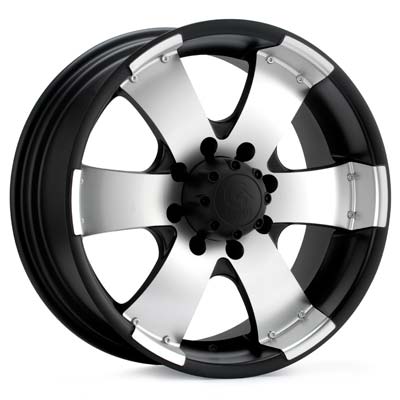

Found these at tirerack.com for $79 bucks each. I figured I might as well. My stock 16 inch wheels have had it.
I got 18x8.5. Now I just need to find the right 32 or 33 inch MT tire to compliment the look.

						NICE! Clean & simple! What's the offset and how's that affect the VX? (I've never mastered the offset stuff....so any explanation would be appreciated....)
						Good choice, make sure to post pics of your VX after you put them on. I think BFG MT KM2s would look on those rims and make your VX look very aggressive.
kat, once the offset has been explained to you once, its pretty easy...
offset is the distance from the center of the wheel to where the lugs seat, so if its a 8" wheel with a 25mm offset (25mm = 1 inch) then the lugs sit 3" back from the face of the wheel, and 5" from the back of the wheel
backspacing is just the distance from the back of the wheel to where the lugs sit, so on the wheel i just gave an example of, the backspacing would be 5"
basically the farther closer to the back of wheel you get (ie lower backspacing or a negative offset) will give make the wheel/tire swing a wider arc when turning the steering wheel, increasing you chance of hitting the outer part of the fender
the farther towards the front of the wheel (ie greater your offset) the farther into the wheel well the more the wheel sticks into the fender so you run the risk of hitting the inner fender
factory on the VX iirc is a 7.5" width wheel with 18mm (0.7inches) so from where the lugs sit, there is approx 3" to the front face of the wheel, and 4.5" to the back of the wheel
when you get an aftermarket wheel, ideally you want to stay as close to that as possible, so stepping up to an 8" wheel, you would want to do an offset of approx 12mm (1/2") so that you have 3.5" to the face of the wheel and 4.5" to the back of the wheel.. of course if you get to a really wide rim this doesnt work because the wheel sticks too far into the wheel well
hope this helps
						Thanks for the compliments guys. I believe the wheels are zero offset. So there would be 4.25 in front of the rim, and 4.25 behind. Totalling the 8.5 inch width.
