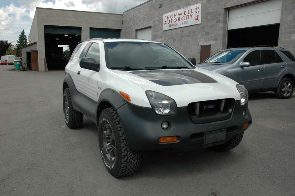

While I was shopping around for a set of rims, I saw a FJ Cruiser parking on the street with this set of rims. So I mark down the rim and tire size. I used photoshop to key in the rims to see how it looks. (It looks pretty good).
The finally step, my friend's staff had the FJ Cruiser with these rims, we took it off his car and put in to my VX for final check with rims and tires fitting before I confirm my order for these set of rims on ebay.
The front cap doesn't fit, I just leave it open. (But it still looks okay to me)
I used 265/75/16 for the tire, cause the supplier don't have 265/70/16 in stock. I have to trim a little bit of the front plastic wheel arch for steering, but you won't notice it.
And I am using TRD P265/75R16 BF Goodrich® All Terrain Tires.
