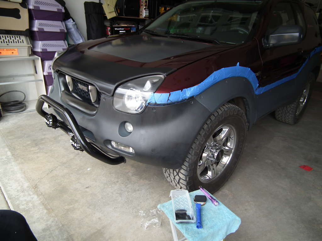

~ Mixed colors in a glass jar, decided on a 2:1 black to gray ratio. Used all 4 oz of black, and 2 oz of gray. Used sponge roller for application.
~ Surface prep is only washing with soap. I used the pressure washer soap/rinse at the coin car wash place. Blasted with soap for 7 mins or so, same for rinse.
~ Did entire truck, and a 2nd coat on front bumper when I ran out. Took about 3-4 hrs.

~ Ordered another 4 oz Black. Got it a week later, mixed up same 2:1 mix.
~ This time I used a 4" foam brush. The roller tended to spew product out of the edges from the centrifugal force, causing you to go over and over it, eventually the product gets too dry to spread properly.
~Did entire truck again with foam brush. Really mastered application technique of long broad light strokes and had very minimal streaking.

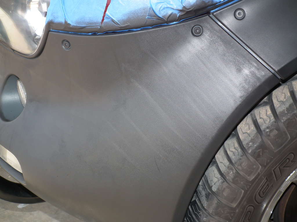

~ I had a real problem with the front bumper on driver's side, since this was where I ran out the first time, and couldn't address the streaks any further cuzs it was drying out. When I used the foam brush for the next coat, it evened out some, but I still wasn't happy.
~ Got wild idea to try sanding area on the front driver's side bumper.Used 2000 grit sandpaper by hand and was able to sand down the thicker splotches.
*** I can ASSURE you this is NOT a topical treatment, it's a dye that's absorbed into the plastic. I couldn't sand the color off despite 30 minutes of rubbing. I ended up with very dark gray particles on the ground after sanding.
I also wiped it aggressively with a wet textured shop rag....nothing came off on rag...so rain will not affect it whatsoever.
~ Used the foam brush and a fair amount of product and redid the front corner again. You can smooth out the product using the entire FLAT SIDE of the foam brush with lighter and lighter strokes to get it smooth. It came out better, but not perfect.

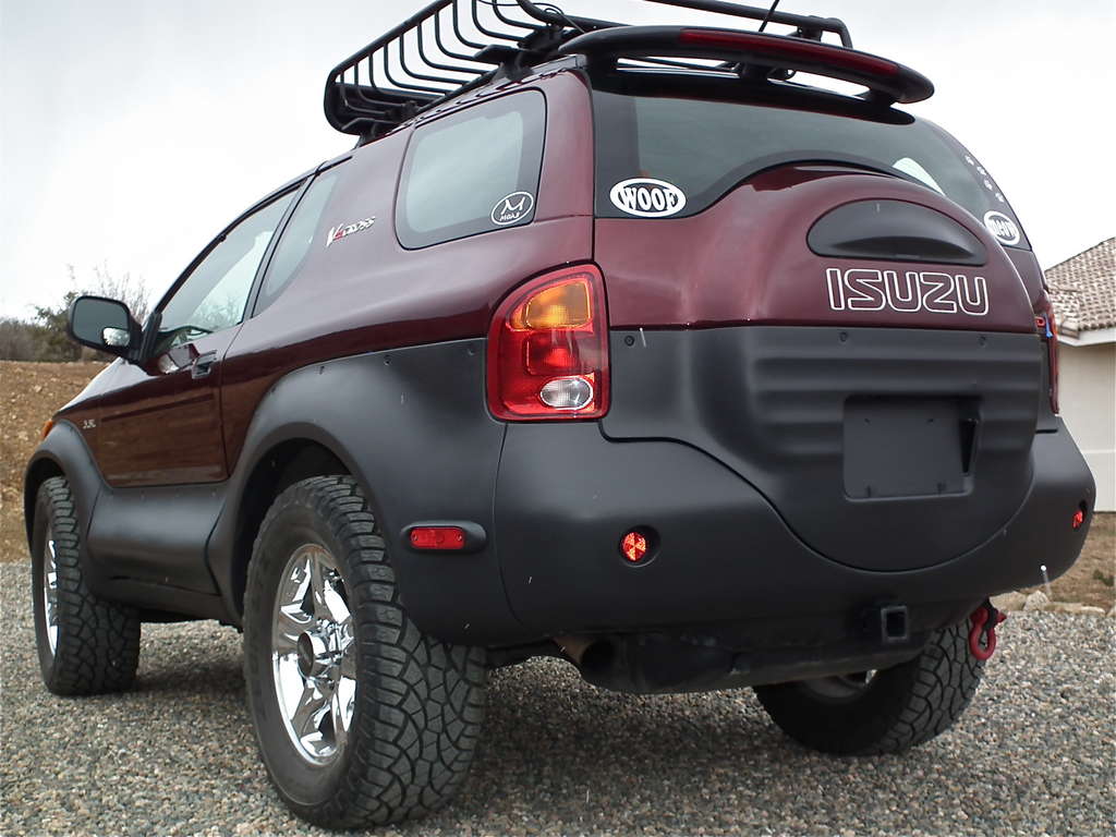

~ Rest of truck came out great, very minimal streaking. After thorough drying, almost all the streaks are gone. I'm very satisfied and love the darker charcoal gray color! It's way way darker than it was.
~It's not sticky, tacky or oily in any way, just a dry matte finish.

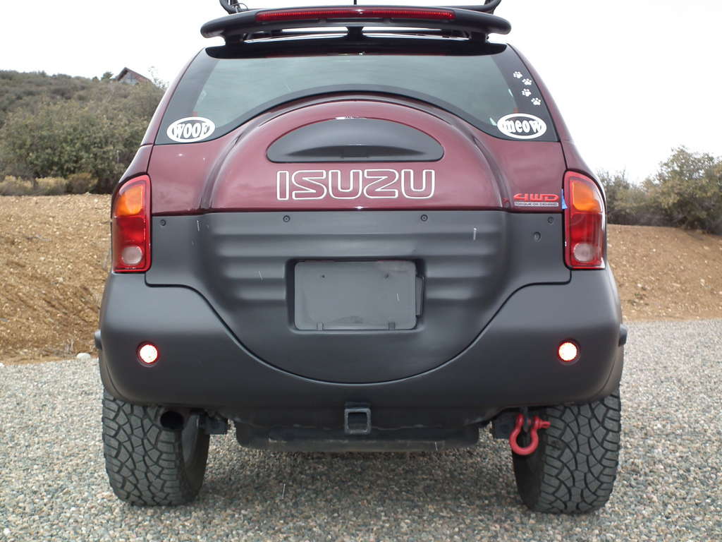

Here's a few pics of the finished masterpiece! (my hood is not latched so it's up a little bit in these pics)
I think it will look great with the silver skid plates that Rowhard is finishing up.
I also installed my clear front turn signal lens covers I got from Bantan!

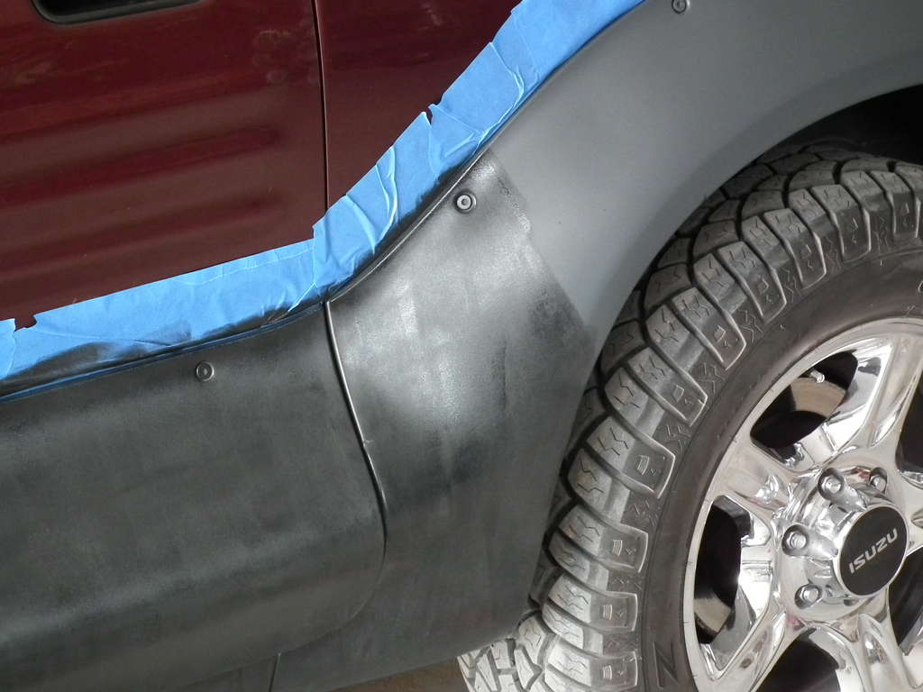

Really shows how light my cladding was. Also, the SN was just freshly applied, very wet. Don't panic (yet)...the streaks magically disappear after it's dried....just do light coats and don't keep rolling it.
This is after first coat, not yet completely dry.
This was after 2nd coat...But this was my problem area cuz I tried to stretch the stuff too far and rolled it too much causing it to dry faster and those streaks weren't budging. Check out the color difference in the front fog lamp area! WAHOO!!
