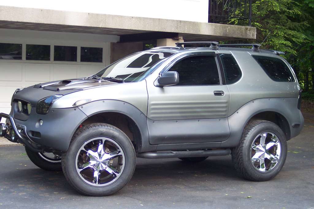

    I have to respectfully disagree with some of what is said. I KNOW that my wheels are +12mm because when I ordered them I was shooting for +10mm since Daver had what I liked in stance. I'm also a stickler for re-checking part #'s on things I order to be sure I received what I asked for. The American Racing wheels I received were the same part# I ordered so in theory if I ordered 12mm offset I should have received 12mm offset.
    +12mm on a 20x8 is different than +12mm on a 20x8.5, etc. Also "where" your tires sticks out to has A LOT to do with the width of your tire. Mine happen to be 12.5" wide and hence they stick out further on my +15 offset rims than would a 11.5" tire, etc. If you look at my gallery when I was test fitting my 20x8.5 +15mm rims before I put tires onto the rims, the rims were almost perfectly in line with the front cladding, may have been a few millimeters outside of the cladding, and since the torsion bar crank pulls the front wheels just slightly in closer to the VX the rears were sticking out from the VX around 5mm more than the front, picture for reference:
    And here you can see the rear tires sticking out just ever so slightly more than the fronts because of the degree of the Control Arms after lifting:
    And no it is not just because of the angle of the photo, at whichever angle you look at it from the rear or front you can see just a slight difference on each side front/back, but I am talking a small difference (3-5mm).

    Yes right on, except as you can see in my photo from above, a 20x8.5" rim with +15mm offset lines up the edge of the rim almost exactly with the edge of the cladding, down to maybe 1 or 2mm sticking out on front at the most, which means my 12.5" tires would be almost 2" wider than this on the inside and outside, so a 0 offset at anything around the same 8.5" rim that I have would indeed push not just the tire outside the wheel well, but it would in fact push the rim edge itself to outside the cladding not just the tire.

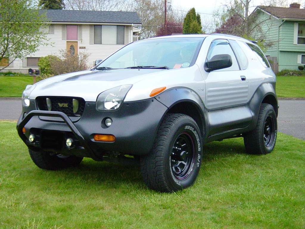

  6. #36
    3,761
    nice littlebeast... that chart is gonna help a lot when it comes to ordering rims lol...

    Here is a chart that might simplify the whole offset to backspacing thing:
    From the chart if your rims are +12mm offset and 4.5" backspacing then your rims would be 7" wide, but that does not sound right either, how were you measuring your backspacing or were you given those numbers?
    Thank you for a very clear, concise, well-written explanation to the subject at hand! kudo's. Very good chart which should come in handy for alot of VX'ers! (myself included!)
    What prompted me to post (earlier) was the implication that some of the posted offset info was wrong (possibly mine being one of them.) So I spoke up mainly to draw attention to the fact that I knew my info (+12mm) was correct.
    The backspacing info I gave (4.5") was in error (actually 5"); but, hopefully I covered my butt with the ole IIRC

    2001 Dragon #0467
  10. #40
    Quote Originally Posted by taylorRichie View Post
    Yours were never in question... only the "0" or "Negative" offset wheels that look "normal" 0 or negative would stick out far no matter how you slice it
    The only thing I can say, is the the Chambers myself and a few other VXers have are a 0 offset with 4.5" backspacing and the tires/wheels do not stick out that far at all. IMO, the 0 offset pushes the look out just right. They look perfect.
