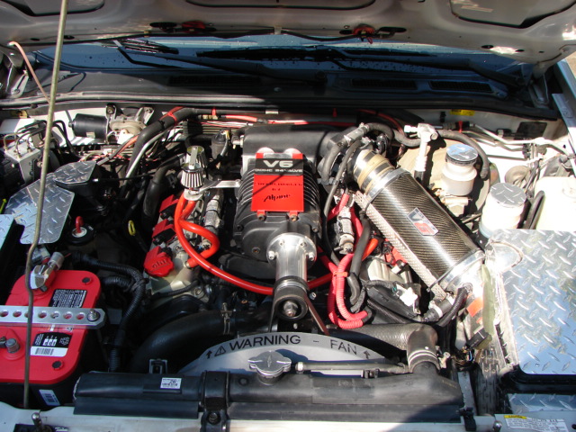

All righty then...I decided to take a "do-over" on this whole crankcase ventilation dealio...
I had been having a problem with oil being pumped out of the breathers & collecting on top of the valve cover, I'm assuming that being under boost may be a contributing factor...at least from some of the articles I've read on the subject, it seems plausible.

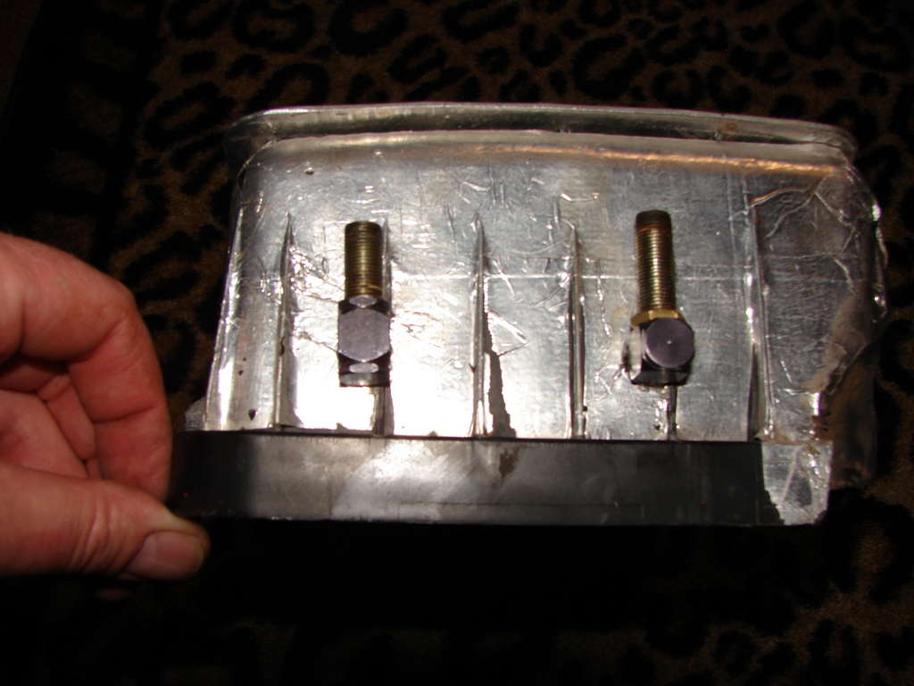

I drilled & tapped two more holes in the top of the tank, then added fittings with a three inch pipe that'll bring the vapors into the tank much lower than the outlets. I had to mod these fittings by using stainless barrels from papermate "G-force" pens, epoxied into the bottom of the fitting, to extend them down into the baffle media.
For the baffle media, I used stainless steel "wool" (kitchen choreboy pot scrubber) to take as much oil as possible out of the vapor before it exits the tank.

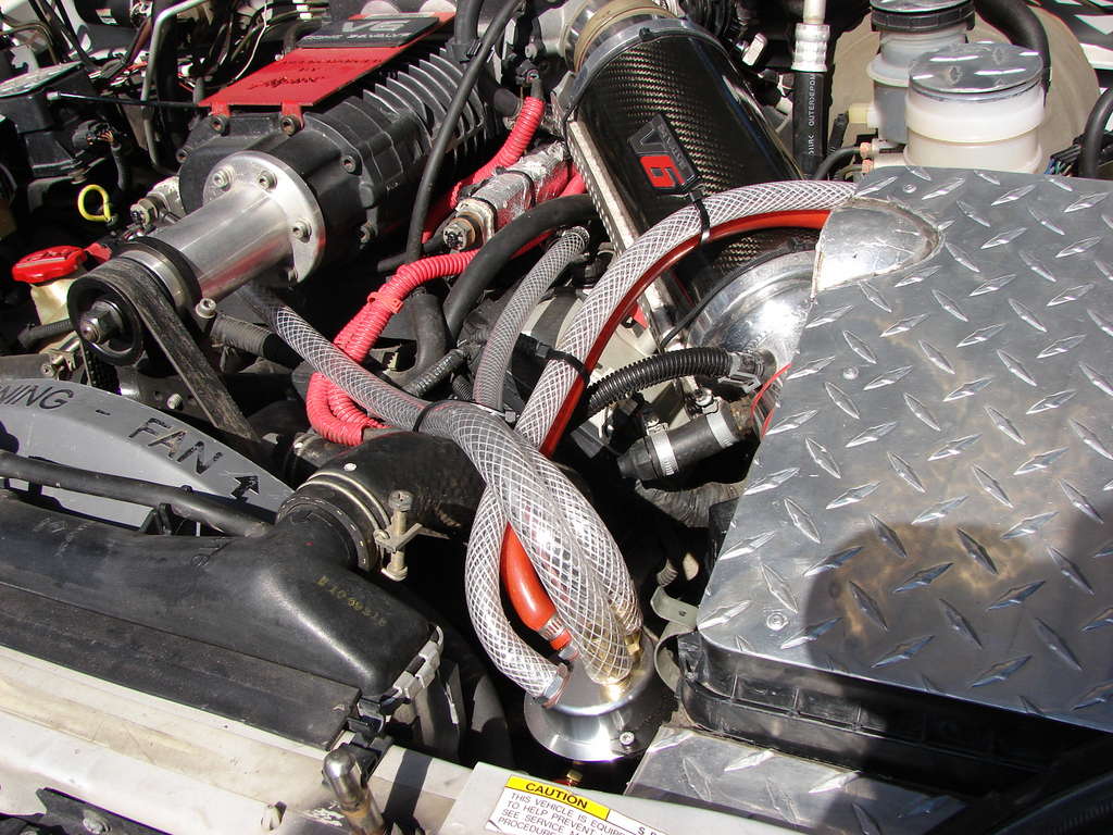

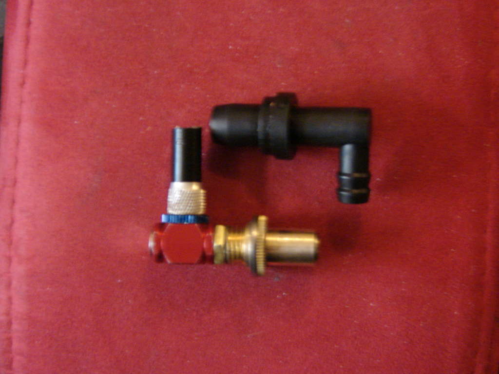

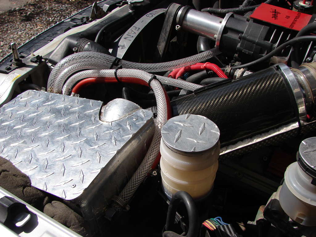

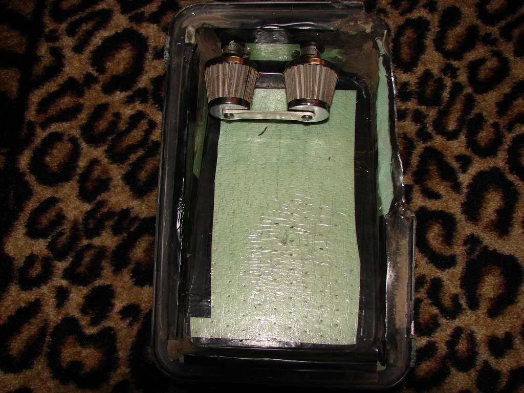

I then removed the vents from their perch on the side of the supercharger & plumbed them into the inside of the air filter box cover.
Cut the various hoses to length, routed them all purdy & zip tied them out of harms way....BAM, hopefully no more fumes in the cabin...
